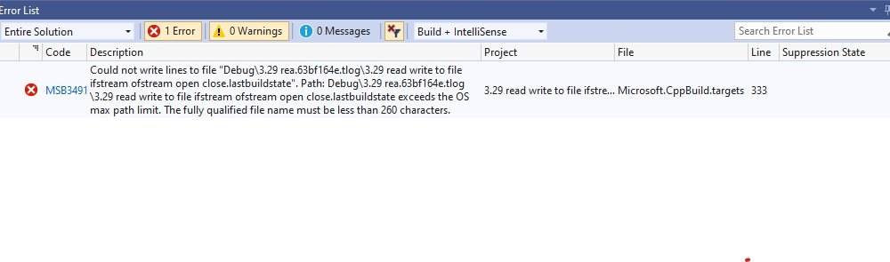

I just ran into problem running this program and I cannot figure out why it gave me an error. Also, it only display the first line that divide the number by 2 and won't display the other 3.
C++:
#include <iostream>
using namespace std;
int main()
    int inputNum = 0;
    count << "Enter a number 0 to 255 = "; cin >> inputNum;// read in a number between 0 to 255.
    int halfNum = inputNum >> 1;
    int quarterNum = inputNum >> 2;
    int doubleNum = inputNum << 1;
    int quadrupleNum = inputNum << 2;
    count << " inputNum divided by 2 = " << halfNum << endl;
    count << " inputNum divided by 4 = " << quarterNum << endl;
    count << " inputNum X 2 = " << doubleNum << endl;
    count << " inputNum X 4 = " << quadrupleNum << endl;
    return 0;
I removed all my own codes, this is EXACTLY the one in the book, still something wrong. The error message is on line 1. This is the error message from VS:
I don't see anything wrong. Please help
Thanks

This is a link error, so this version of your code can not be run, but your description sounds like it started to run something old that was already linked.
Something is funny about VS, I ran into a .cpp that was running well and all of a sudden it gave me funny result when I reopen the file. Somehow it's ok again.
The last two days, it kept saying a new version of VS is available. I did not click yes because it's a big file and look like it's going to take a long time to upgrade. I thought while the going is good, I don't want to rock the boat. But now that I want to upgrade, the window doesn't show up anymore. Now I have no choice, it's running right now.Update, it doesn't help, still the same thing. Now I definitely need you guys to help. I really don't see anything wrong with what I have. This is a very simple program, I just don't see what I did wrong even ignoring the error message, it only display the first line as if it skip the next 3 count display.
Thanks
