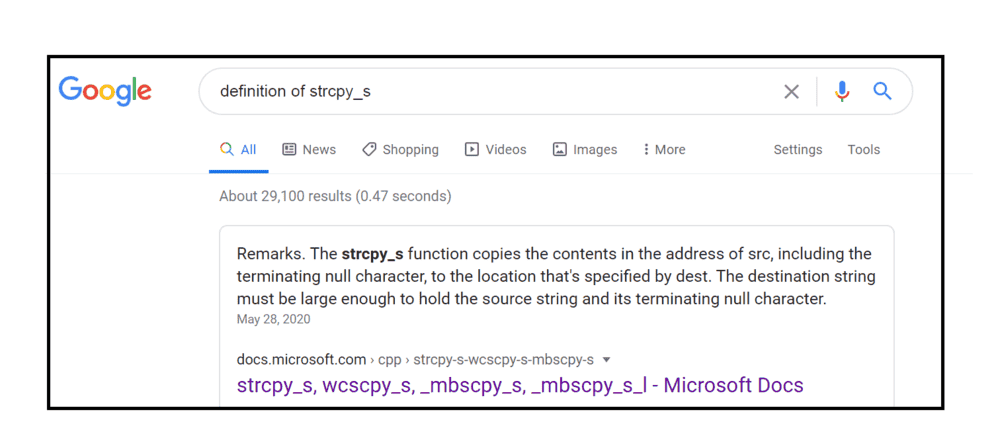

sysprog said:
I just highlighted "definition of strcpy_s" from your post, right-clicked, selected "Search Google for "definition of strcpy_s"" from the context menu, and got this:View attachment 266730
Remarks. The strcpy_s function copies the contents in the address of src, including the terminating null character, to the location that's specified by dest. The destination string must be large enough to hold the source string and its terminating null character.​
The link leads to a full explanation. It's true that, as you put it , "It is NOT easy to google and learn C++", but being able to do searches on things is a great aid in learning things, and of course, not everything that is worth learning is easy to learn, by any means.
I actually copied this link already yesterday, that's the one that I commented about hard to read. I even copy onto a word doc and modified to make it easier to read. I am still checking, seems like the order of the parameters are switched from what Mark44 suggested. I need to play with the program to verify.
