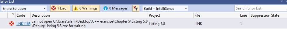

Update:
This is really funny. I had problem with this that did not make sense two days ago. I loaded and ran this program today. Everything ran and gave me the correct display! I did not change anything, I just gave up two days ago.
This is NOT the first time I run into strange problem with VS. I had issue of another that I ran ( Ctrl+F5) and got the same result in debugger no matter I change the code. I exit VS and re-ran the program, it's the same. I even restarted my laptop, still the same. But somehow, it ran fine later on. VS doesn't seems to be that reliable.
It almost seems the debugger got stuck with the last run and keep displaying the same without even running the debugger. Seems like when this happen, the cmd window comes up right away as soon as I hit Ctrl+F5. In normal running, it usually takes a few seconds running through, display something before the control panel screen appears. It's almost it just keep displaying the stuck page.
I've been using VS for 22 years, and can't remember ever seeing the problem you describe. If you change the code, you need to rebuild your program. Just hitting CTRL+F5 might be just running the code you had before you made the change.
yungman said:
It almost seems the debugger got stuck with the last run and keep displaying the same without even running the debugger. Seems like when this happen, the control panel comes up right away as soon as I hit Ctrl+F5. In normal running, it usually takes a few seconds running through, display something before the control panel screen appears. It's almost it just keep displaying the stuck page.
I don't know what you're describing here, especially about the control panel coming up and the debugger getting stuck. The Control Panel is a feature of Windows, not VS. It allows you to make changes to the computer.
Again, I think what you might be seeing is that you aren't rebuilding (i.e., compiling and linking) your edited program to produce a new executable.
I meant cmd window. I change that already.
That sounds like my problem, I only hit Ctrl+F5.
What do I have to do to rebuild and link the program after I modify the code? I thought Ctrl+F5 is doing that already.
In the menu bar near the top of the VS window, click the Build menu item. The drop-down menu that opens has Build Solution (F7), Rebuild Solution (Ctrl+Alt+F7), and Clean Solution, and other commands. When I make a change to my source code, I usually hit Rebuild Solution.
Clean Solution gets rid of all of the object files and the executable, letting you start the build process from scratch.
