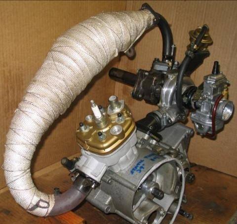

  • #31
No tuned exhaust on this one, very broad torque curve from idle to max rpm. Here is a pic of a tuned exhaust expansion chamber with a turbo.
  • #32
This is not your sled correct?
You think there is a big difference between the two set up?
Manifolf>turbo
Manifold>Tuned pipe>turbo
Luth

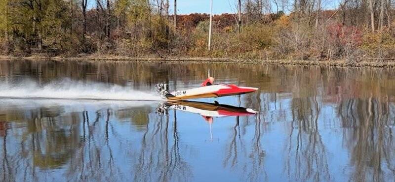

  • #33
I own the sled in the pic, not me driving though. This was a blow through carb set up that seemed to work but on my outboard it never worked out for some reason. Draw through is real easy, carbs are sensitive to the pressure of blow through. You either have to pressurize the entire carb with the boost pressure or pressurize the top of the float bowls through the top air vents. A tiny change in external carb pressure means a lot of fuel mix change. The area that I choose to get the boost pressure to feed the float bowls had a simple tube installed in part of the intake that had boost. Depending on the slight angle the end of the tube was cut at and by rotating the tube would cause a big variation in jetting, if I am clear in explaining it.

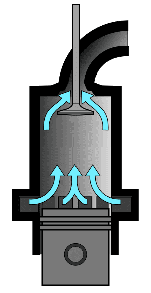

Very interesting thread.
In my opinion, when you put a turbo, you change the pressure & temperature everywhere. Therefore a tuned exhaust is most likely untuned (detuned?) with the turbo. If it's really bad, then it won't work at all.
But it may give positive effects. For example, if the pressure wave doesn't come back at the "right" time, you can effectively lower the compression ratio.
The reason why the above engine without a tuned exhaust work is greatly due to the fact it uses a variable-geometry turbo. It allows to tune the restriction by modifying the back pressure in the exhaust outlet. Otherwise, you would have to match carefully the right turbo to the engine. Even then, it would probably not work very well outside a very narrow rpm range.
Supercharged diesel two-stroke engine
were used on GM trucks and were apparently very good engines. To my knowledge all supercharged two-strokes used a valve to control the flow (uniflow scavenging).

Interesting the uniflow but there is used an exhaust valve that simplify the use of a turbo. But here speak about gas engine 2 stroke gasoline Reeds or piston port!
