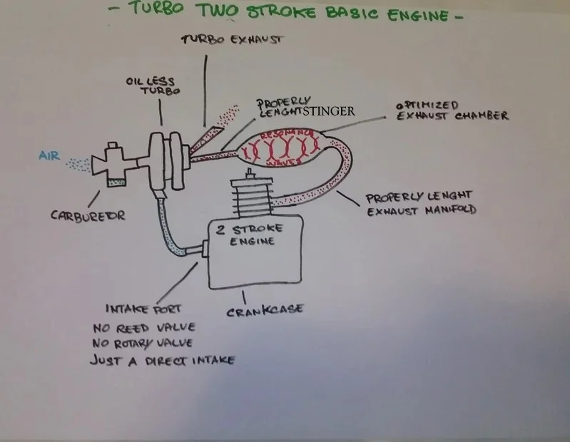

  • #62
Luth said:
IS this research valid?
No.
They claim to have designed their own turbo. But the unit pictured on the first page is a commercial unit with a manufacturers tag. There is no mention of balancing a turbo. There is no picture of their turbo installed on a bike.
They claim to have a waste gate on the exhaust manifold to limit the charge.
There is so much that appears to be imagined in this paper.
Maybe the Prof needed to be lead author on another publication, so he got a student to write it.

  • #72
Luth said:
50cc 2 stroke do a complete cycle anytime so could be correct match a turbo used in a 100cc 4 stroke?
Yes, but "could be" are the appropriate keywords.
  • #73
There are too many words missing. I could not understand the question.

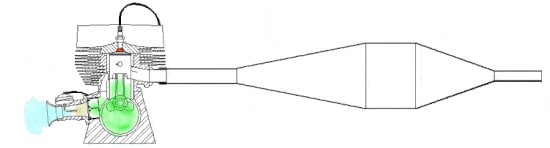

Just signed up here after googling a little regarding my next project. And lots of guys here with practical experience, but a few logic flaws that made me sign up here. As an petrolhead, engineer and flawed two stroke motorbike racer(I was a coward in the corners) I do have the practical experience with tuning high performance two strokes and I understand the physics behind it.
Some here talk about back pressure and how an engine needs it to work. That is simply not true and are conclusion based on observations you do not understand.
An engine thrives when it has a low back pressure that helps extract the exhaust. An high back pressure will restrict engine power.
What your experiencing when you remove the exhaust off an 4stroke is a loss of bottom end power because of increased back pressure. An exhaust system Transports pressure and sound pullses that translates into a low pressure on the exhaustvalve. What this exhaust system is removed the atmospheric pressure will act on the exhaust valve creating a backpresure. When you move on to 2strokes understanding how sound and pressure works with the dynamics become even more essential. How do you guys think honda got 200hp from its NSR500 20+ years ago? The design is to my knowledge still an secret to this day.
An blower on a two stroke would work just as well as an turbo since there is no extra backpressure needed, but efficiency could become lower but with and wider powerband. Maybe a blower setup would produce more power at an better efficiency because you could throw the reedcage away and get rid of that resistance.
For the exhaust I would just throw the original expansion chambers and fit larger ones. The exhaust volume would be larger so I would think a that you should design the chambers according to cylindervolume*atmospheres. So if running 3 atmospheres of boost on a 50cc you should use chambers from a 150cc to obtain max results.
How much boost you could run would simply be limited by the pressure spike from the reflecting wave.

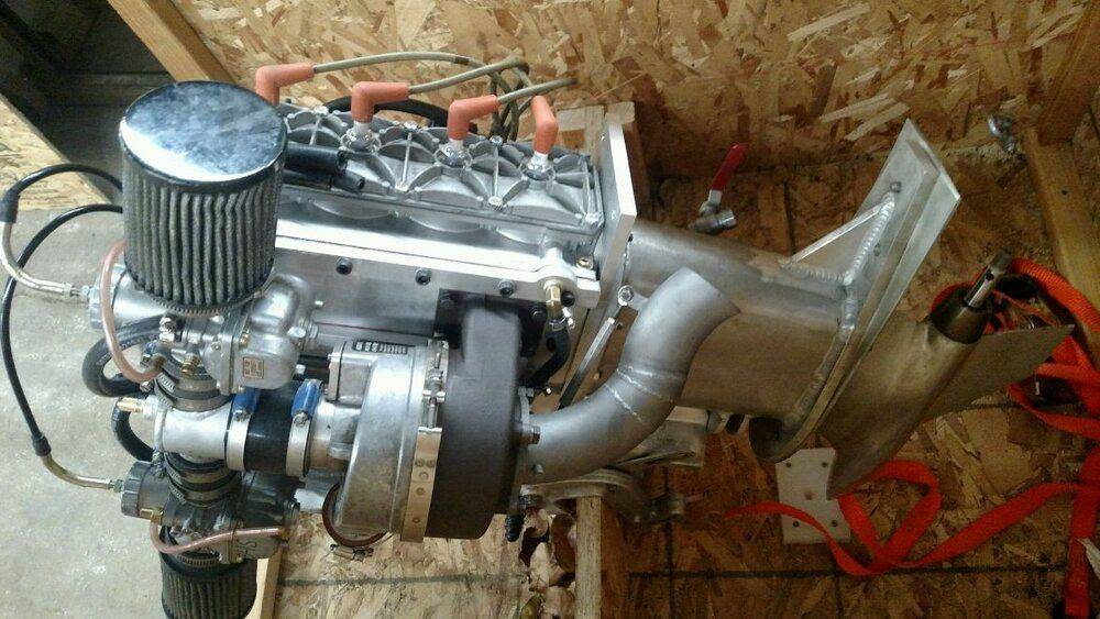

  • #85
bluechipx said:
Here's a shot of the assembled Merc with the Aerodyne turbo.View attachment 269366
Man, I NEED to do this with an inline 6. If you still look at these forums please get back with me.

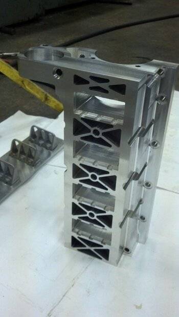

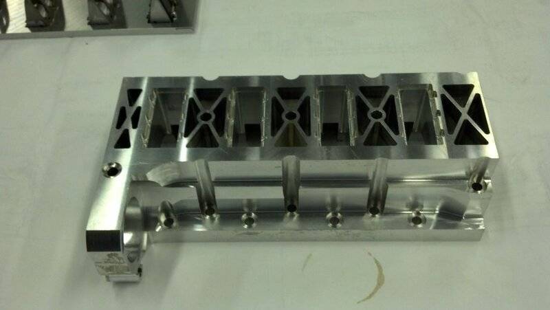

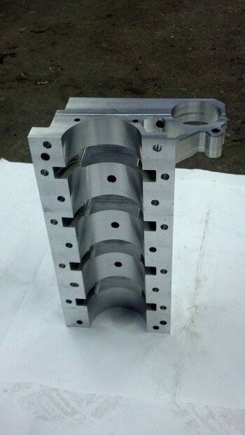

Not the perfect engine for adding HP. The long somewhat frail crankshaft I feel was at the edge in stock form. Either a V-4 or V-6 is a much stronger unit. The small inline four cylinder Merc thast I used had the front half of the motor (crankcase) that supported the crank and took a lot of thrust from the firing cylinders and barely weighed a pound! I happened to have a solid billet block of 7075 aluminum that was just the size to make a real strong crankcase out of. Also the turbo was hard on reeds and and in stock form you had to almost completely tear the engine apart to get at thev reeds. My new crankcase had a much smaller internal volume and used pyramid style reeds that are almost external and easily changed.
  • #90
Was that done with a cnc? If so I have access to materials and the machines, and I can get one cranked out probably pretty easy. Would you happen to still have the files on it if it was cnc?
