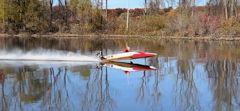

In case anyone is still following this thread, I did a real stupid thing last fall and nearly died. I have a formula/champ style one person tunnel hydro with a moderate v6 2.5 liter mercury on it. They all have power trim and trimming the engine angle is critical for controlling the bow lift.
I was just going to go for a easy ride and never even told anyone I was doing it. It was just going to be a easy run so I wasn't even wearing a helmit (I know, stupidity!). I had the trim set very conservatively and gradually increased my speed as I was going from river to lake in near calm wind. A recovered and dried gps read 118 mph. At somewhere around 118 mph the bow lifted so rapidly that there was no time to trim out of it.
All I could see was sky when I tightly closed my eyes and put a deathgrip on the steering wheel. I knew this was going to be a bad one. After a few seconds I felt a hard jarring and opened my eyes to see I landed upright in the water, unhurt and not even wet! A quick inspection showed the rear cowling gone and a badly leaking gas tank which broke loose. I stopped the leak by tipping the tank and was afraid to disconnect any electrical contacts to prevent sparking and igniting an inch or more of gas in the entire bottom of the hydro.
I removed my shirt and soaked up the gas like a sponge. Apparently I did a complete 360 and landed in a headache producing thud. It was one hour before a friend in a jetski came to tow me back. Not one other boat came by in that hour.
I have never given up on any project but this time I am. The boat is shrink wrapped and I'll never drive it again. In fact I'll destroy it before I sell it unless a person can do some real convincing that they have a ton of experiance and I don't have to hear they either died or were badly hurt in it. Google 'tunnel boat blowovers' for some footage of accidents others had and you will see how lucky I was to walk away unhurt but somewhat smarter!

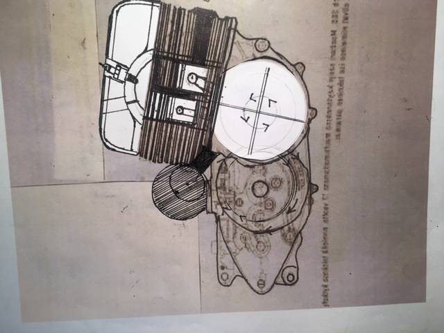

Thanks for the reply. I'm hoping that with internal oiling, the exhaust piston can have direct oil cooling to cover that. ports will be direct from the s/charger and or then turbo if possble. The a radicall split single design offers opportunities not found in normal two strokes. (see att. as a possibility)
Peak revs can be to 5000 rpm when needed. It needs 850000 ccs per minute at that rpm. some roots types (300 and 500) models are available from China. would one of them be adequate. Mazda use one type with their new valved 2 stroke.

Aircraft offered better piston cooling opportunities than did static engines. Air cooling of opposed pistons can be improved over split cylinders. The split two-stroke, evolved into the opposed piston two-stroke aero-engine during the 1930s.
That then became the Napier Deltic engine in the 1950s, used in ships and trains.
Those superchargers are low-cost, and have a capacity greater than required for your engine. However, the following description suggests (in its last line), that a turbocharger, rather than a blower, might be more efficient.

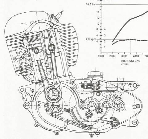

It is a single-shaft, gas turbine engine, with a hybrid combustor.
Air is compressed, then fuel is added,
that mix passes into a cyclic cylinder combustor, with spark-ignition,
energy is extracted by the piston, to the crankshaft and flywheel,
the exhaust drives the turbine, which is on the compressor shaft.
