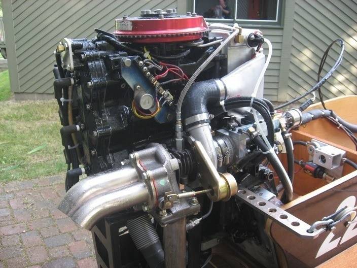

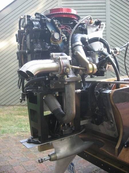

Just stumbled on your site and offer a cool turbo project I built in 2010 and tested in 2011. This will put to bed questions about the feasibility of two stroke turbos. At 56.1 CI, this may be the smallest successful 2-stroke turbo outboard ever built. Volumetric formulas predict it delivers 153 HP at 8000 RPM. Am pretty sure it's all of that. Seach youtube for Tim's turbo Johnson and you can see/hear it run. Fantastic!
Tim
