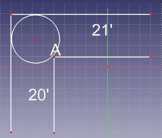

I have attached a diagram that might aid in me understanding what you need.

I downloaded a free CAD program. What exactly would help?
Note that while the road is only 20' and 21,' at the turn the 21' road extends out to the Eastern property line where the 20' road intersects it, i.e., an upside down L.
A really accurate scale plan would help. It looks marginal - no to be ruled out totally so we need to have some really accurate data.

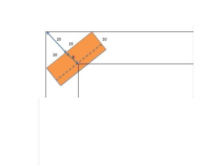

I just found this unposted so I thought I'd post it anyway. The (crude) diagram could help with the discussion.

My initial simple diagram assumes the road is 20' wide everywhere and that the trailer is 40' long with perfectly square ends. The crux is at the 45 degree point on the way round.That triangle ( top left) made by the trailer side and the two walls will be 20' from the apex to the trailer side. The diagonal width of the road is near enough 28', leaving you with just 8' for the trailer's width. Not enough unless you can shave some off that corner, have some overhang or use a shorter trailer.
Having one track wider by 2' and various practical differences suggest that it may not be absolutely impossible but there are other problems like the paths the wheels would take - despite your idea of shuffling it round with a fork lift (you could only get to one end at a time - so you would need two tractors!)
This is annoying for you because it isn't too far out but you could consider a shorter trailer and that would be really easy.
