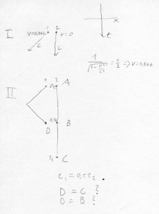

I'm trying to make sense of the way time dimension is related to the other 3, the example is twin paradox:
Observer 1 is moving away at 0.866c from observer 2, who is standing still, then turns around at a defined point and goes back at the same speed, arriving back to observer 2 position, and see him 0.5t older than classically expected.
Now, the problem with that visualization is why are the points D and C are the ones that are in the same "now"?
Why does 1 not arrive at point B instead and see the 2 at 0.5t also?
Are the points B and D not at the same space&time coordinates?
Alternatively, why, if C and D are the same, can they see each other?
Because it implies that things could be seen across a distance in time dimension, which contradicts the fact that we don't see our past and future trailing around us, and things can't be seen in two places at once.
Or, is there something fundamentally wrong with that visualization attempt?

An alternative visualization is to use the proper time of the twins, instead of the coordinate time as dimension. Then you see that the twins don't meet at the same proper time coordinate. Here are both diagram types for comparison:
http://www.adamtoons.de/physics/twins.swf
The main problem of this visualization is that you cannot draw one simple space time diagram for the twin that turns around, because space time is curved in non inertial frames. But you can split it in two inertial parts for leaving & returning as done here.
You are not drawing the spacetime diagram correctly.
First and least important, by convention, we draw them with time going up the page, not down. Not important mathematically, but if you stick to the conventions it will be easier for others to understand.
Second and really important, someone somewhere has told you "all bodies travel through spacetime at a speed of c," and you have taken this waay too seriously. You are trying to draw line segments of equal length for equal periods of coordinate time because you think that since everything travels at c, they all travel the same "distance" for the same "time," but in different directions. This is incorrect.
For instance, take a light ray, which must make a 45 degree angle in a spacetime diagram. However, lines of constant coordinate time are horizontal lines corresponding to t=0, t=1, t=2, etc. If you draw a spacetime diagram for a stationary observer and a light ray, then the observer starts at the origin and ends up at the point (0,1). The light ray starts at the origin and ends up at (1,1). One second of coordinate time has passed, and the length of the observer's worldline is 1 on the diagram, and the length of the light ray's worldline is [itex]\sqrt 2[/itex]. Faster bodies have longer worldlines on a spacetime diagram, because in 1 unit of coordinate time, they move up the diagram by one unit but also horizontally by an amount [itex]\beta[/itex].

Artlav you do not need to use “Space Time Diagrams” to do this, IMO at you level you are better off not using that as it can become a crutch without understanding the problem. Just use what you have already laid out, BUT you must be much more complete.
You are missing some definable events and measuring points. And, have worked out the solution in only one POV or reference frame. You cannot expect to understand the issue unless you work out all the elements of the problem including calculating them from the POV of all frames of reference – you only used one.
You define events A B C for observer 1 which stays stationary in ref frame 1.
But you only give D for observer 2.
And you only work out the solution in ref frame 2.

The start for observer 1 needs to be defined: Call it A1
The turnaround needs to be defined: call it T
(B is not T; B is when and where observer 2 is at the same time that the turn T is made)
And you did define the ending point for observer 2 as D.
But you also need to define the start point: call it SP
And the turn point: call it TP
And the end point call it EP
Note these are locations that do not move, not events.
Now SP, TP & EP are easy if as you did only workout the problem based on ref frame 1. These locations are based on ref frame 2 where SP & EP are the same location. But they are not at the same location in the other reference frames!

Now with a more complete discription of all the elements involved you are ready to go back to work.
From all these locations, movements, events and frames of reference what can you say you know with absolute certainty no matter what else might appear to be true?
Only two things:
1) events A1 & A happened simultaneously at SP
2) events D & C happened simultaneously at EP
All Frames using their POV must agree that these events are two things are true in a realistic reality.
You need to work out a complete solution giving the time and location for every point at all event times.
And redo the same solution from the POV of the other two reference frames as well.
Sorry that means you need to actually do the math! But other than just taking our word for it, that is the best way to actually understand this stuff. and two or three pages of work for each ref frame POV is small price to pay.
IMO, That is the best way to make clear that the classical cannot reconcile this paradox,
but SR does by giving results that show all frames agree on the times and locations given by the other frames for events A1 & A and events D & C.
But other than those two facts none of the frames agree on any other element of the problem. Including where and when SP and EP are physically located at any other event times and the never agree on where and when T, B, or TP are.
That leads directly to how Einstein defined the Simultaneity Rule, meaning you cannot trust the synchronization of any frame as a correct measure of Simultaneous events.
