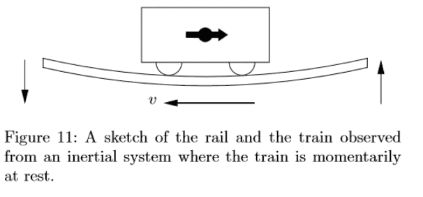

See for instance figures 3 and 11 in https://arxiv.org/abs/0708.2490v1
The paper is about another effect (one which is also interesting but irrelevant to this thread, and effect called Thomas Precession). However, it illustrates some interesting facts about the floor, we can say that if the floor is flat in an a specific inertial frame that we declare to be "at rest" in the x and y directions, it will not be flat in another inertial frame that's moving in the x direction. (Or in the y direction, for that matter, but the case above analyzed the motion in the x direction)

Why don't the vertical velocities of the rail ends result in a tilted rail?
How has the left end of the rail advanced more than the middle of the rail?Hmmm ... ok I have figured it out, the rail is both curved and tilted. Because that's what the result of the depicted motions is.

Perhaps I'll think of a better way to explain it more intuitively, but at the moment all I have time to do is go through what the math says.
The ship with the flat floors is accelerating in such a manner that a gyroscope does not precess, with some acceleration g.
The block sliding across the "flat floor" of this accelerating ship has a different value of proper acceleration, and a gyroscope mounted on the block does precess, and it has a different, higher value for it's proper acceleration. ##\gamma^2 g##, as I recall.
For the first point, see https://arxiv.org/abs/0708.2490v1

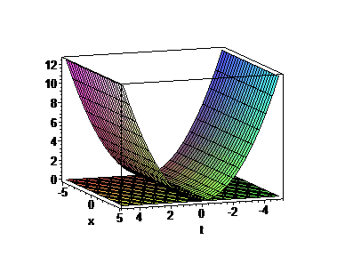

which plots like this. It's just a parabola in the {z,t} plane, with the value of z independent of x.
On this diagram, the surface of the elevator is the set of points {z,x} that satisfy the above relationship at some particular time t. We will consider specifically t=0, then the set of points composing the elevator is z=0. We can represent this by plotting z vs x, and finding that z is constant, the floor of the elevator is a straight line. It's a straight line and not a plane because we've surpressed the y dimension in our analysis, so we can draw a 3d space-time diagram.

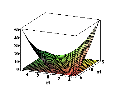

Now, on this space-time diagram, the surface of the non-boosted elevator at t=0 is the set of points {z,x} that satisfy our relation for z. It's easy enough to see that z is not a function of x, so if we plot z versus x, we get a straight line.
On the boosted space time diagram, we want the surface of the elvator at t'=0, rather than t=0. So we write z' as a function of t' and x', which gives us the following
$$z'= z = \frac{1}{2} t^2 = \frac{1}{2} \gamma^2 ( t' + \beta x')^2$$
We can see that at t'=0
$$z' = \frac{1}{2} \gamma^2 \beta^2 x'^2$$
which is the floor of the elevator that was constructed to be flat in our first coordinate system. We can see that it's no longer flat in the new coordinate system.
With ##\beta=3/5## and ##\gamma=5/4##, the complete space-time diagram for the elevator looks like this.
