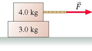

hey guys, i was wondering if you could please help me
question:
The coefficient of static friction is 0.60 between the two blocks in figure. The coefficient of kinetic friction between the lower block and the floor is 0.20. Force F_vec causes both blocks to cross a distance of 5.0 m, starting from rest.What is the least amount of time in which this motion can be completed without the top block sliding on the lower block?
this is a very tricky question
force of friction for lower block: Ff= 13.72N
Fsmax= 23.52
so the force being exerted has to have a max of 9.8N
F=ma
9.8= 7a
a=1.4 m/s^2
i have no idea how i can get the time from this

so here, i tried to incorporate it into the kinematics equations
http://www.glenbrook.k12.il.us/GBSSCI/PHYS/Class/1DKin/U1L6a1.gif 5=.5(a)t^2
and got a time of 2.67s, which is wrong
Where did the friction enter into the problem?
You have jumped a step to far in your choice of equations. Start from F=ma, you should have something in your text relating the friction to this fundamental starting point. You have 2 friction problems to do here. The first will tell you the maximum acceleration you can have without the top block slipping. Then that acceleration and the friction between the floor and the bottom block will give you the time you need.

so
a=fmax/m
= 5.88m/s^2
d= .5at^2
5= .5(5.88)(t^2)
t= 1.304 (wrong)
:frown:
Consider the maximum force applicable to the blocks : [itex]F = 0.6 \times 4 = 2.4[/itex]. Now apply this to the body of two block (m = 7) to give you the maximum force, which will allow you to calc. the acceleration.
guys, thanks a lot for helping
ok so f=ma
2.4=7a
a= .349 m/s^2
d=.5at^2
t= 5.4s (this comes out to the wrong answer)
sorry to bother you guys..
You forgot to factor in the force of friction during movement.
ah yes! thanks sooooo much
it came out to 1.75
