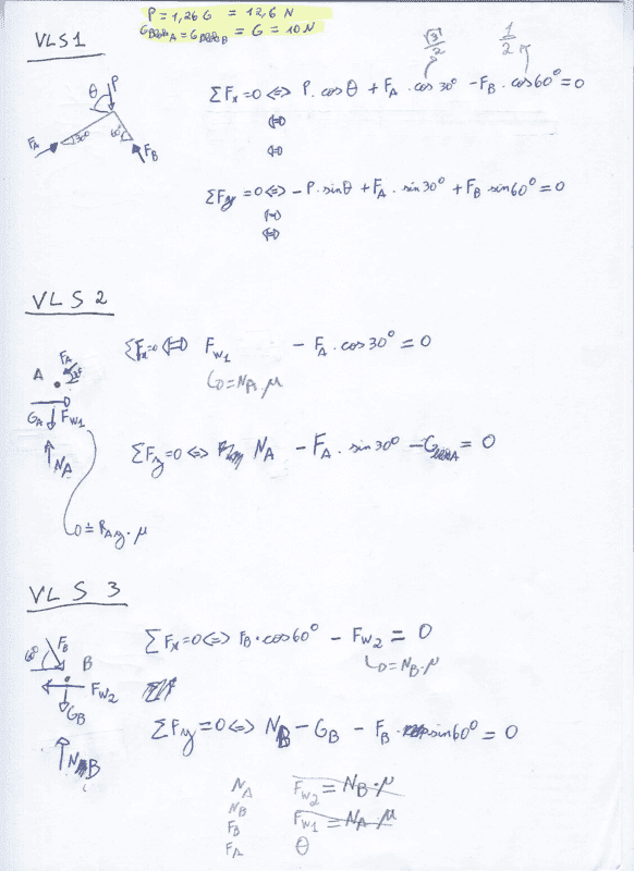

melanie1235
see picture below
see picture below

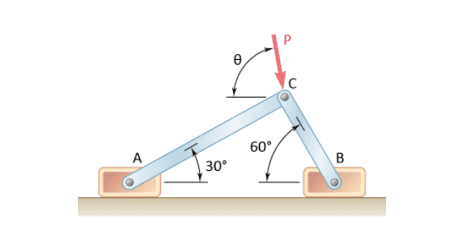

A force P is exerted on two articulated rods that are connected to two small blocks A and B. Both blocks have the same weight G. The magnitude of the force P = 1.26 G. The static friction coefficient between the blocks and the ground is 0.3. The mass of the rods may be neglected.
It can be shown that this construction will remain in static equilibrium when the angle θ lies between the angles α1 and α2 or between α3 and α4.
What are the values of these four corners?
Note:
all angles are between 0 ° and 180 °
sort the values of these four corners from smallest to largest
this is my part of the solution: I'm in trouble because the value of sin(θ) is larger than 1.
Can somebody pleas help me, I'm desperate.

There are two ranges of angles within which, if force P is applied onto joint C, will induce movement of block A or B or both.
One range of angle θ is located somewhere to the left of the vertical line passing by joint C (possible values to calculate should be between 0° and 90°).
The second range of angle θ is located somewhere to the right of that vertical line (possible values to calculate should be between 90° and 180°).
It seems that you have incorrectly calculated the values of P and G.
Value of G (weight of each block) is unknown and not needed.
The problem is telling us only that the magnitude of force P is 1.26 times the magnitude of each force G.
I recommend working backwards from the posible forces acting on each block towards the forces acting along rods CA and CB, which angles remain as shown in the diagram.
There will be ranges of the magnitude of forces CA and CB that wil make the blocks slide.
The magnitude of each of those forces will change as the angle at which force P is applied onto joint C changes between 0 and 180 degrees.

Yes the given angles are fixed
I mean, in equilibrium the angles have a magnitude of 30 and 60 degrees

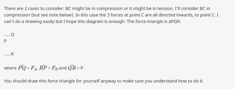

Now the tricky bit. The 3 forces acting at point C are ##F_A##, ##F_B## and P. We could try analysing these forces using components, but we soon get into a terrible mess (I tried it!). But we note the rods are perpendicular and we can easily use the force-triangle for these 3 forces in equilibrium at C.
There are 2 cases to consider: BC might be in compression or it might be in tension. I’ll consider BC in compression (but see note below). In this case the 3 forces at point C are all directed inwards, to point C. I can’t do a drawing easily but I hope this diagram is enough. The force-triangle is ΔPQR:
...Q
P
...R
where ##\vec{PQ}## = ##F_A##, ##\vec{RP}## = ##F_B## and ##\vec{QR}## = P
You should draw this force triangle for yourself anyway to make sure you understand how to do it.
QR is θ to horizontal. PR is 60º to horizontal. So ∠R = θ - 60º. Since ∠P = 90º:
sinR = PQ/QR = |##F_A##|/ |##P## |
sin(θ - 60º) = 0.419/1.26
θ = 79.4º
So one of the required angles (α₁, α₂, α₃ or α₄) is 79.4º. (But you need to check all my arithmetic.)

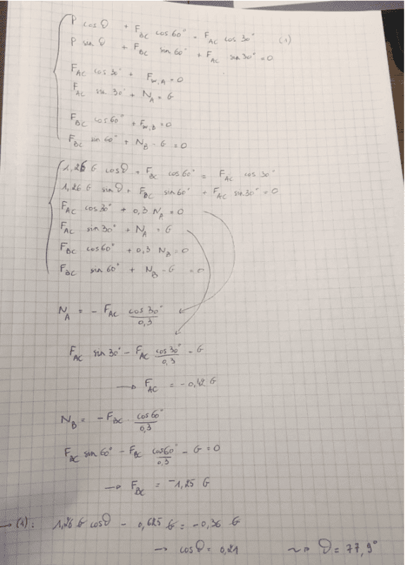

Thank you very much for your answer, I get it! I understand how to calculate one angle. But I have still no idea how the calculate the other angles.
The method is exactly the same for all the other angles. If you think you undertsand my method, write out your own solution (for block-A slipping left) without looking at my answer. Then see what you get and refer to my answer to identify/analyse any differences. That will improve your understanding of the basic method.

Actually I don't really understand this part of your solution
I need the answer at 7 PM so I'm a bit stessed out ( in Belgium it is now 3 PM)
