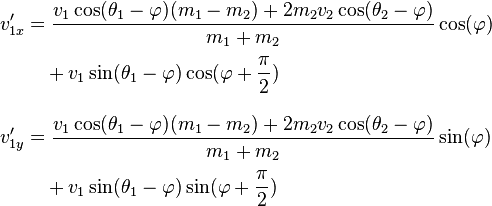

Two moving objects (circle shaped) with a known mass, move in a 2D plane with a known constant direction and speed, at certain point, objects collide with each other (elastic). At that point, the coordinates of the center each object is known, their radius is also known, their Vx and Vy are known (everything what's needed is known, almost). Determine the final speed vector for each object
[/B]
I found this equation:
What exactly are the theta and phi angles and how are they calculated on a cartesian plane.
Are they calculated in radians or degrees for that equation (I guess that they are in radians, due to the final 1/2 pi).
I have some troubles determining the angles (theta and phi), because I am not sure whether or not I have to add them certain values (180, 180, 360) depending on the different quadrants( +x+y, -x+y, -x-y, +x-y).

A physics equation has no value unless the variables it uses are defined. Wherever you found those equations, you should also find those definitions. Maybe you don't understand the definitions given, but if so you need to quote those definitions in your post so that others can interpret them, but it's a bit tough trying to guess the definitions from these equations alone.
Better still, ignore those equations you found, make up your own variable names, and people on this forum can help you develop your own equations from the basic laws that apply. What are those laws?
Based on the diagram at the link, the two theta angles are the angles to the x-axis made by the trajectories of the approaching discs. Phi is the angle to the x-axis made by the line through the two centres when the discs touch.
The author has been inconsistent, showing theta2 as measured from the -ve x direction but the other two from the +ve x. Looking at the equations, theta2 is really measured from the +ve x direction, so the diagram is wrong. The equations' theta2 is pi plus the angle shown. (Getting this wrong will affect the signs of the trig functions.)
All three are measured clockwise from the reference, whereas the Cartesian standard is to measure anticlockwise. However, that makes sense because down is +ve Y in the computer's representation.
It depends what your trig functions expect. Radians would be standard.
Getting the trig signs right can be quite a challenge.
E.g. for finding theta1, you use arctan(vy/vx), but that only gives an answer in a range of pi (-pi/2 to +pi/2 I would guess). For the equations, you need to know the angle in a full 2pi range. To determine that, you have to look at the sign of vy and/or vx. If vx is negative the object is heading left, so the angle must be in the range pi/2 to 3pi/2. To correct, just add pi to the arctan result.
You also need to protect against zero-divide in calculating vy/vx.

Thanks a lot for your help. I have corrected the equation based on what you have suggested, I just have to find the correct angles to make the objects bounce.
I have a few questions:
1. Do I have to use the same phi for both objects?(pretty sure I have to).
2.
theta2 = (PI + "theta2")
Just to be clear, the equations shown at the link are correct. The error is merely in the way theta2 is drawn in the diagram.
Yes.
Vold said:
Vx:-1.0
Vy:-1.0
theta, deg:45.0
Because Vx<0 you need to add pi. And as I mentioned, you need to check for Vx = 0 before calculating the ratio for arctan's argument.

     * does not use the best solution to it - adding 0.001). It calculates the angle with
     * Math.atan(dy/dx). So, the conditions are there to correct certain angles due to that
     * it does not cover the full 2 PI range. But, what are those corrections? I am clueless.
    public double theta(){
        if(this.getVelX() == 0 && this.getVelY() == 0)
            this.setVelX(0.001);
        if(this.getVelY() > 0 && this.getVelX() <= 0){
            return Math.PI + Math.atan(this.getVelY()  / this.getVelX()) ;
        }else if(this.getVelY() >= 0 && this.getVelX() > 0){
            return Math.atan(this.getVelY()  / this.getVelX()) ;
        }else if(this.getVelY() < 0 && this.getVelX() >= 0){
            return 2*Math.PI + Math.atan(this.getVelY()  / this.getVelX() );
        }else //if(this.getVelY() <= 0 && this.getVelX() < 0)
     * @param m
     * @return phi: the angle of the collision of the objects with the X axis.
     * currently the conditions are only useful to prevent Y/0 division (pretty sure it
     * Note: the position of the objects is based on x+radius, to check where is the center,
     * because x,y point is located at the upper left of the object.
    public double phi(GameObject m){
        if(this.getYr() - m.getYr() > 0 && this.getXr() - m.getXr() <= 0){
            return Math.PI + Math.atan((this.getYr() - m.getYr()) / (this.getXr() - m.getXr()) );
        }else if(this.getYr() - m.getYr() >= 0 && this.getXr() - m.getXr() > 0){
            return Math.atan((this.getYr() - m.getYr()) / (this.getXr() - m.getXr()) );
        }else if(this.getYr() - m.getYr() < 0 && this.getXr() - m.getXr() >= 0){
        //ok
        }else //if(this.getYr() - m.getYr() <= 0 && this.getXr() - m.getXr() < 0){
    public double getXr() {
        return getX()+ getRadius();
    public double getYr() {
        return getY()+ getRadius();
I wouldn't be surprised if the errors are due to typos, I just fixed several in other part of the code. :p
I think that I am getting close to the solution, the objects bounce correctly at some angles. My biggest burden is the inverted Y-Axis, which makes me make mistakes with the adjustment of the angles.In regards to the last part of your previous post, I just realized that I was talking nonsense. the distance is checked correctly.
For the arctan logic, you don't need so many cases.
I would start by defining a constant as the max value you allow as the result of a division, MaxReal, say.
Then your test for potential overflow is abs(Vx)*MaxReal < abs(Vy). When that returns true, angle=pi/2, else angle = atan (Vy/Vx).
Either way, you then adjust for negative Vx, if ((Vx)<0) angle += pi. That should be it.
Likewise for phi.
I see you have a problem with coliding objects getting stuck. I assume this is because as they try to separate after a collision they appear to collide again.
You could solve that by checking whether their relative velocity along the line of centres is bringing them closer or taking them further apart. With your existing method, seems to me you could have problems when there are multiple collisions in one time step.
I managed to get it right with your input. I will now try to solve other problems related to it. The objects sometimes get stuck as you say, regardless, I am planning to have some animations that allow me to simulate some kind of 3D effect where if an object collides it can either go up or down or also get destroyed, etc. Still, I will try to fix it.
Thanks a lot! :D
