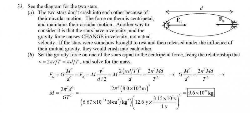

My solutions guide shows that the orbit of the two stars is an elongated ellipse (see picture). It states that ##F_R = M \frac{v^2}{d/2} = M \frac{2(\pi d/T)^2}{d} ##
It is clear that the writer used the identity ##vT ## = displacement = ##2\pi R ## Is ##2 \pi R ## valid for ellipses?

The problem statement says that: "The two stars don't crash into each other because of their circular motion. " So I would consider the image to depict a view of the orbit that is more edge-on than overhead.
Thank you, I see it now. However, if the orbit were the shape of an ellipse, the circumference will not be ## 2\pi R ## right? Thanks Gniell
Right. If the orbit were elliptical the circumference would not be ##2 \pi R##, and furthermore, the velocity would not be constant around the orbit.
