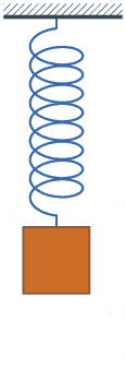

One spring is located inside a wider spring. Both ends are welded together and hanged from a tree. both springs are ##30 cm## long when not deformed. The first spring has ##30 g## and ##k=5 g/cm## the second spring has ##60 g## and ##k= 6g/cm##. How deep under the branch will be the bottom weld?
My idea was to calculate the deformation of each spring separately. Let's say that ##s_1## is the deformation of the first one and ##s_2## deformation of the second one.
Of course one will have greater deformation than the other, but when welded together, this means that one of the springs will have to carry some of the mass of the other spring with greater deformation.
For easier writing let's say that the second spring has greater deformation than the first one. So my idea was to calculate how much mass of the second spring, will the first one have to carry. I think I could do that because I know the difference between the springs deformations.
This would than mean, that the total distance of the bottom weld from the top one is a sum of deformed length of the first spring + additional deformation of spring no. 1 because it has to take some the mass of spring no 2.
Even explaining what I am trying to sounds too complex to me. So, is there an easier way? Or even better, is this even the right way?
I would love to show you my calculations yet the problem is that I have absolutely NO idea how to calculate the deformation of the hanged springs due to gravity. Whatever I do, everything seems do deduct down to zero in the first two steps :(
OK, no calculations to show. Fair enough. Some deliberations, perhaps ?
Make things easier to start with: cut the lower weld. How far does each one stretch then ?

a). It has mass of 30 grams and NONE of the springs has any additional weights attached.
Yes, the problem is that I am not even sure about that part but here is how I tried without any success.
##dx## part of the spring should stretch for ##\delta x##. Meaning ##k\delta x=\frac{l-x}{l}mg##. But the problem is I have no idea what to do to get integral on the right side, so I tried to use hooks law
##SE\frac{\delta x}{dx}=\frac{l-x}{l}mg##
but I have no information about ##E## ... ?

Ok se we all agree now that the deflection of single spring is
##ES\frac{\delta l}{dz}=\frac{l-z}{l}mg##
##ES\int_{0}^{\Delta l}\delta l=\frac{mg}{l}\int_{0}^{l}(l-z)dz##
##ES\Delta l=\frac{mg}{l}\frac{l^2}{2}## which is the same as ##\Delta l=\frac{mg}{2k}## where ##k=\frac{ES}{l}##.
So ##\Delta l_1=\frac{m_1g}{2k_1}## and ##\Delta l_2=\frac{m_2g}{2k_2}## threfore the difference is ##\Delta l_1-\Delta l_2=\frac g 2 (\frac{m_1}{k_1}-\frac{m_2}{k_2})##.
Basically my idea was to calculate how much mass this difference represents: ##m_2\frac{\Delta l_2}{l+\Delta l_2}## meaning it should be the same as if I hanged that amount of mass on the first spring:
##F=k_1s##
##m_2g\frac{\Delta l_2}{l+\Delta l_2}=k_1s##
##s=\frac{m_2g}{k_1}\frac{\Delta l_2}{l+\Delta l_2}##
So the total distance from the top to the bottom weld wold be ##\Delta l_1+s##.
This feels wrong for several reasons:
- I didn't use any integration in the second part and it feels like I should.
- I simply assumed that the second spring will stretch more than the first one, which may not be the case.

The deflection is the same at the bottom of the two springs, but saying they "work as one" and calculating the equivalent stiffness is too simplistic.
Imagine you have a slinky spring, in parallel with a stiff and light elastic band. The mass of the slinky will slump towards the bottom much more than the mass of the elastic. In fact you could get a situation where the bottom of the slinky was in compression, not tension, being pushed upwards by the reaction to the tension in the elastic.
skrat has got the differential equation for the stretching of one spring. The "m/2" formula comes from the boundary condition that there is no external force applied to the bottom of the spring.
I think what you need to do is write the two DEs for each spring, and impose the boundary conditions that
1. The displacements at the bottom of each spring are equal
2. The forces applied to the bottom of each spring are equal and opposite, but not zero.

30 cm, 60 g spring by itself, k = 6 N/m g = 10 m/s2 , is 35 cm long
No compromises now (welding them together doesn't yield a 34 cm whole, although the 34 cm answer might earn you a smal credit), no more democracy, just brainwork.
Still too daft to write the DE, so I'd like to repeat the poor man's integration with a little extension: ##F_{12}\ ## pulling up the bottom end stiff bloke from 35 to 30 + x, and ##F_{21}\ ## pulling down the light one from 33 cm to 30 + x. ##{\vec F}_{12} + {\vec F}_{21} = \vec 0\,##, of course (right?).
Can't use the slinky concept any more (bottom turns don't behave like F = -kΔx under compression). But otherwise I see no objections to my cheapo approach... any takers ?
Hmmm, is it ok to say
##m_1g\frac{l-x}{l}+m_2g\frac{l-x}{l}=S(E_1+E_2)\frac{\delta x}{dx}## where ##\delta x## is a stretch of ##dx## and where I assumed that cross section of the springs is the same and constant.
Integrating this leaves me with:
##\delta x=\frac{g(m_1+m_2)}{2(k_1+k_2)}=4 cm##
Well I am not sure why you need to assume the same cross sections. The stiffnesses k1 and k2 of each spring are given, and these values are based on spring material, cross section, coil spacing and thickness, unstretched spring length, etc., of each spring. It's already built in.
Anyway, I get the same result of 4.09 cm which to one sig fig is 4 cm, and which agrees with BvU's poor man's approach for at least partial credit. :-p
