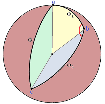

Suppose two successive coordinate rotations through angles ##\Phi_1## and ##\Phi_2## are carried out, equivalent to a single rotation through an angle ##\Phi##. Show that ##\Phi_1##, ##\Phi_2## and ##\Phi## can be considered as the sides of a spherical triangle with the angle opposite to ##\Phi## given by the angle between the two axes of rotation.

I'm not sure how rigorous the derivation needs to be. But if you construct a diagram of the spherical triangle, then the result appears to follow immediately by inspection of the diagram.

OK. I don't see a rigorous derivation at the moment. For what it's worth, here's the diagram that seems to me to show the result.
Start with a spherical apple. Let a radial line sweep out the arc Φ1 from a to b, slicing the apple along the yellow plane. Continue with two more slicings Φ2 and Φ along the blue and green planes, respectively. Remove the wedge of apple that has been sliced out. The picture above shows peering down inside the apple. The red angle is the angle opposite Φ. This angle is clearly the angle between the yellow and blue planes. The result follows by considering how the angle between the yellow and blue planes is related to the angle between the rotation axes corresponding to Φ1 and Φ2.
Hopefully, someone can provide some hints on constructing a rigorous argument.
