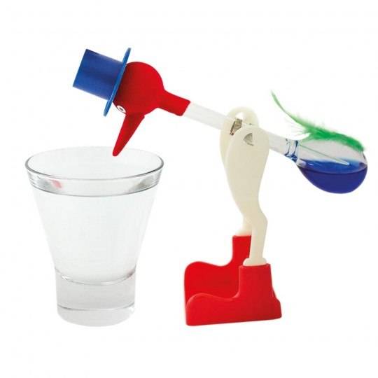

This pump doesn't use any electricity... :smile:
http://shop.australiangeographic.co.../BEBN-duncan-the-drinking-bird-outbox-web.jpg
