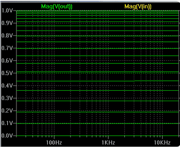

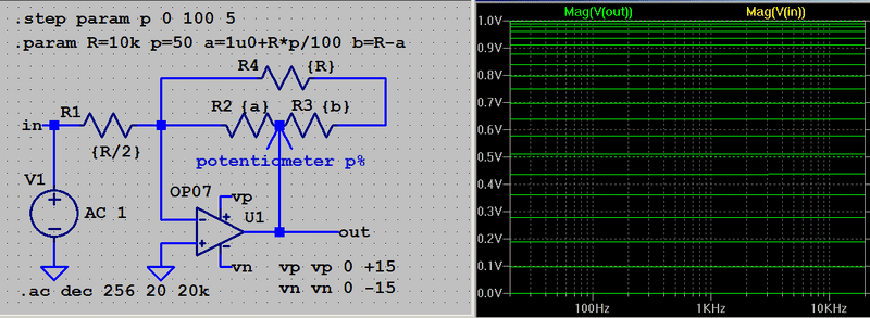

As the pot is adjusted linearly from p=0 to p=100%,
the gain of the amplifier varies from: G=0 to G=1-(p/100)2.
That is a close approximation to the form of a cosine function.
The two sides of the pot R=a+b, are simulated here by R2=a, and R3=b.
I'm not seeing the curve on the plot @Baluncore ...?
The plots are for 5% steps of the pot setting. Each line represents the gain across the audio spectrum for a different setting. Notice how the lines get closer at the top. If the gain was simply proportional to the pot position, then the gains would be equally spaced.
100% pot gives a gain of 1.000
95% pot gives a gain of 0.9975
90% pot gives a gain of 0.990
65% pot gives a gain of 0.877
50% pot gives a gain of 0.750 which is close to the 0.7071 wanted
30% pot gives a gain of 0.510
10% pot gives a gain of 0.190
5% pot gives a gain of 0.0975
0% pot gives a gain of 0.0000

I used LTspice to document the circuit diagram, and to demonstrate that the gain is proportional to 1-x2, not linearly to shaft angle x.
Here, the approximation circuit; 1-(1-x)2; is plotted in yellow,
with the first quadrant of sine(x), plotted in magenta.
