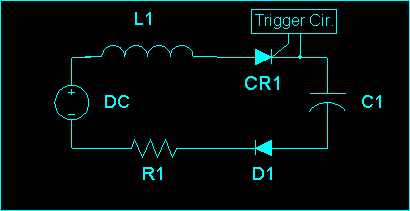

Wasting a lot of power in a form of heat ain't good. Why not to use inductor+diode in series to charge the caps? You can find smoothing chokes at reasonable price ($10<) on ebay.

Hi,
Is there a circuit diagram that shows the use of inductor+diode to charge the caps? Is this instead of a balancing resistor? The idea is to charge the caps up quickly (but not quickly for them to explode) and to discharge quickly. Would Zener diodes be more useful in this instance?

This is basic circuit. Condition 2√(L1/C1) >R1 should be met in order to save some energy. Since your supercap has huge capacity, you'll have a difficulty to find choke big enough, with small enough wire resistance R1. One modification of this circuit is to employ two-stage resonant charging with significantly higher DC voltage source and smaller cap C0<< C1 on first LC stage. Then energy in C0 is transferred to C1 via circuit C0-L1-C1-R1. If you don't have experience/knowledge in designing such circuits, you better don't do it. Overvolting supercap means sure death it. I don't believe you have low voltage DC source capable of delivering currents like 1 kA, and charging cap too quickly won't happen. Charging them by simple series resistor that can withstand dissipation level works ok. Discharging fully charged supercap is more problematic. Too quickly (short circuit blast) isn't good for lifetime of the cap. Some SCs can withstand such abuse many times, some not.
Just noticed this isn't correct what I wrote . The correct condition should be √(L1/C1) > 2R1.
