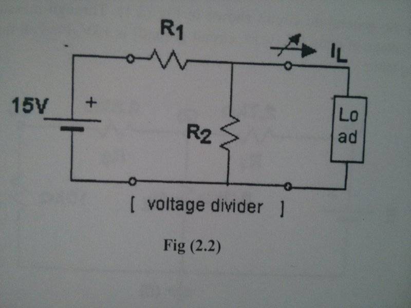

The attached figure shows a simple voltage-divier connecting a dc voltage source to a variable resistive load. Design the voltage divider to provide a voltage of about 5V (+/- 10%) across the variable load. The load-current demand varies in the range of 0 to 5mA, and the available dc-supply voltage is 15V.
V=IR
equivalent resistance across parallel circuits: R1*R2/(R1+R2)
equivalent resistance across the series circuit: R1+R2
I understand that the voltage across the Load is 5V, which would mean that the voltage across the R2 resistor is also 5V. This would mean that the voltage drop across R1 is 10V since KVL states the sum of voltages across a loop must be zero. I also know that the voltage divider rule states that the voltage across V(R2)=15*(R2/R1+R2).
I am not sure how to move forward from here. Please help

The voltage to the load is allowed to vary +/-10% as the load current varies between 0 and 5 mA. At the extremes of the current values, what load voltages would you associate with them? Can you write expressions for those two cases? (hint: you might consider using nodal analysis for the 5 mA case).
This would mean I would first assume 0 mA through the load and find what the voltage is across it. Wouldn't this make the voltage across the load be 0 since V=IRm where I is zero. Then 5 mA through the load and write an expression for what the voltage would be across the load? The question is asking to design the voltage divider to provide a voltage of about 5V (+/- 10%) across the variable load. What is this really asking me to find?

sugz said:
This would mean I would first assume 0 mA through the load and find what the voltage is across it and then 5 mA through the load and write an expression for what the voltage would be across the load? The question is asking to design the voltage divider to provide a voltage of about 5V (+/- 10%) across the variable load. What is this really asking me to find?
It wants you to choose resistors for the voltage divider such that when the load current varies between 0 and 5 mA the load voltage stays in the range 5 V +/- 10% .
5 V +/- 10% tells you what the minimum and maximum voltages are. You should be able to make an educated deduction as to which of the two current extremes are associated with each of those voltages. Write expressions for the two scenarios incorporating those voltage&current pairs.

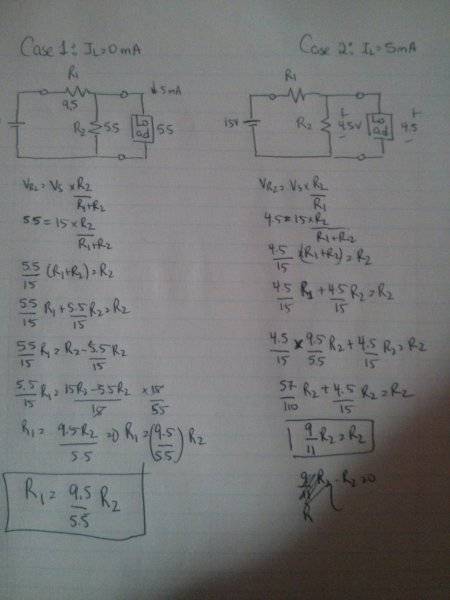

Hi, this is the calculation I performed for the two cases. However, I noticed that with two unknowns (R1 and R2), I end up with the two equations as shown in the attached document. I used the voltage divider rule to get these equations. Do j make an assumption for one of the resistors and the second one is dependent on tbr first one I assume? It seems as if this is the only way it can work out.
Your case 1 is good, only the figure shouldn't show 5 mA current for the load, since the case if for IL = 0 mA.
The second case is not so good. You've not included the 5 mA load current in your derivation. I suggest using nodal analysis to do so easily; the load current just becomes another term in the node equation.
You will end up with two equations in two unknowns. They can be solved for R1 and R2.
Yes, you are correct. I intended the voltage across the load in the first case to be 4.5 and not 5.5. I will redo this part again. For case 2 where IL is 0mA, I thought since the load current is 0mA, I would not included it in my derivation. Am I missing somwthing?

The figure headings say: "Case 1: IL = 0 mA" and "Case 2: IL = 5 mA". The accompanying circuit diagrams say the opposite. But in fact your work for Case 1 reflects the no current scenario: there's no load current in the equations, and it uses the 5.5 V maximum voltage as expected for a no-load case.
Unfortunately the Case 2 labelled work also shows no current, despite the header which says it should.
You need to include the 5 mA load current and 4.5 V output voltage in your equation for the loaded case.

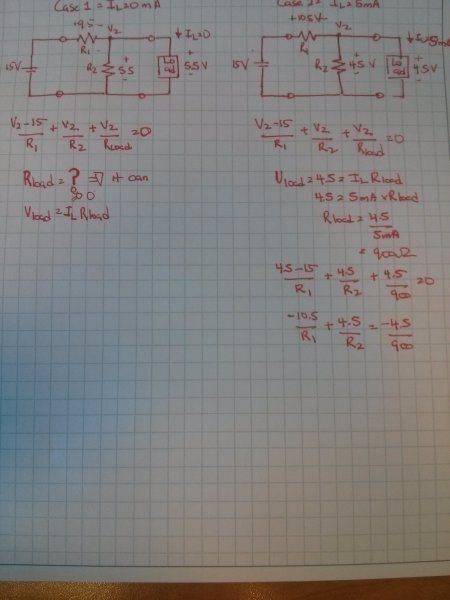

Sorry about the confusion. I must have not been thinking straight as it was very late. I have re-done the steps again, which has been attached here. Case 2 (IL=5mA) seems good. All I need to do is solve for R1 or R2 in case 1 and substitute it into Case 2 equation to solve for the resistor value. However, I have a question related to Case 1. when IL =0, wouldn't we not have a voltage drop across it since V=IR? I am not sure how to calculate the Resistor of the LOAD when IL=0. I am going to try to answer this..Please correct me if I am wrong. When IL=0, the load part of the circuit becomes an open circuit, leaving only R1 and R2, where the voltage across R2 is 5.5V.

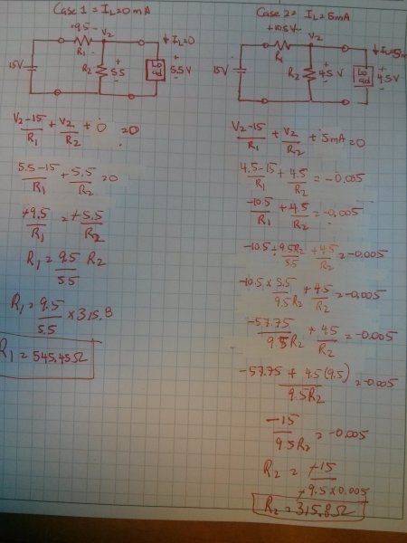

Don't use V/R form for the load current in the node equation. You aren't given a particular load resistor value (and it's obviously changing from case to case). Just use the current value itself, it's much simpler. The terms of a node equation represent branch currents.
When the load current is zero then yes, it's equivalent to an open circuit. This is the same as putting '0' for the load branch current in the node equation.
You are totally amazing! I believe I have figured it out. The values were R1=545.45 ohms and R2=315.9 ohms. Although this was actually simple, with your guidance, I have learned a lot of concepts which I would have not if someone had simply given the answer. I have attached my steps here for reference. Thanks again for your patience and help!
Looks good! Glad I could help. Keep practicing, and good luck with your studies!
Hi,
I have one last question related to case 1 where the load current is 0 mA. How is the voltage 4.5 when the load current is 0. Should it not be 0 as well since it has to be v=IR?
sugz said:
Hi,
When the load current is 0 mA then the output voltage 5.5 V. But that's not so important now.
When the load current is zero then the load resistance is equivalent to an infinite resistance. That is the same as it being removed entirely. No matter what voltage you put across it there will be zero current flow.
