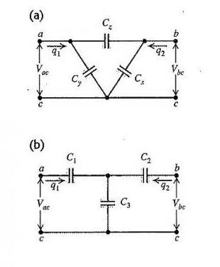

Hello everyone. The problem is related to these two capacitor connections:
In the enunciate it is said that these two are equivalent and it is requested to prove that:
  1. C1=(CxCy+CyCz+CzCx)/Cx
  2. C2=(CxCy+CyCz+CzCx)/Cy
  3. C1=(CxCy+CyCz+CzCx)/Cz
C=Q/Vab (Capacitance definition)
My problem with the solution is that I do not know how to analyze them, because of the two potentials differences.
My progress:
It is seen that the two potential differences and the two electric charges are the same in the two arrangements, so I tried to isolate Vac and Vbc in function of the electric charges: to no avail.
I noticed that in the first image, the capacitor at the top will have an electric charge merged from the two originals, that I call q3, so the left capacitor will have a charge of q1 - q3 (or q1+q3?) and the another will have a charge of q2+q3(or q2-q3?), I believe of that order do not import.
Can you give me a light on how to do this? Sorry for my poor English, I'm not proficient.

The first configuration is a π (Pi) configuration, and the second is a "T" configuration. I think the best way to work with this is to express the capacitors as impedances. Figure out the math to make the input and output impedances the same, and the transfer functions the same.
You could also do it first for resistors, since the math is a bit simpler for resistors. Maybe try it with resistors and post your work here so we can comment? :smile:

You understand that the question is saying that whatever the voltages applied, if you apply the same voltages to both circuits you will see the same external charge flows, right?
What equations can you write for the two circuits?

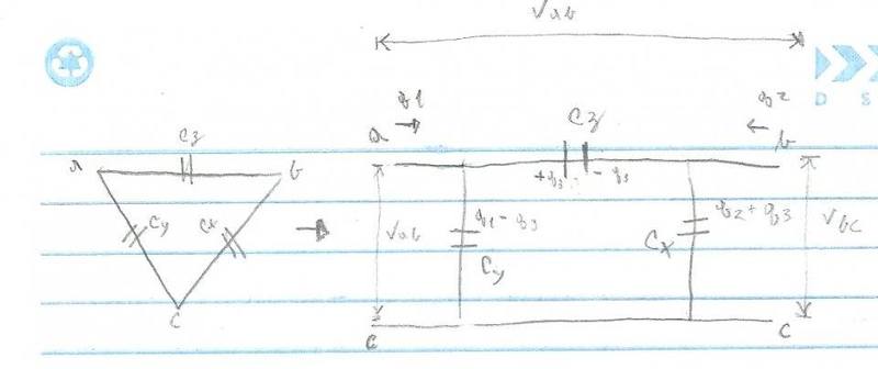

Redraw the Delta circuit for a Pi
And I conclude that:
Vac = (q1 - q3)/Cy
Vbc = (q2 + q3)/Cx
Vab = q3/Cz = Vac + Vcb = Vac - Vbc
q3/Cz = (q1 - q3)/Cy - (q2 + q3)/Cx
q3 (Cy Cz + Cx Cz + Cx Cy)/(Cx Cy Cz) = q1/Cy - q2/Cx
∴q3 = Cx Cy Cz / (CyCz + CxCz + Cx Cy) [q1/Cy - q2/Cx] ≡ K (q1/Cy - q2/Cx)
∴ ( I ): Vac = q1/Cy - K q1/Cy2 + K q2/(Cx Cy)
( II ): Vbc = q2/Cx + K q1/(CyCx) - K q2/(Cx2)

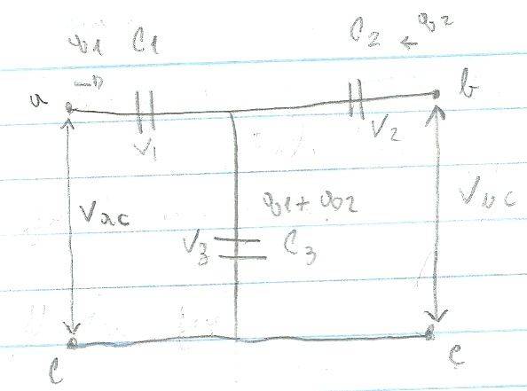

In the second circuit:
( III ): Vac = V1 + V3 = q1(1/C1 + 1/C3) + q2/C3
( IV ): Vbc = V2 + V3 = q1 (1/C3) + q2 (1/C2 + 1/C3)
Equalizing the coefficients:
( III ) = ( I ):
  • 1/C3 = K/(Cx Cy) → C3 = (Cx Cy + Cy Cz + Cz Cx)/Cz
  • 1/C1 + 1/C3 = 1/Cy - K/Cy2 → C1 = (Cx Cy + Cy Cz + Cz Cx)/Cx
( VI ) = ( II ):
  • 1/C2 + 1/C3 = 1/Cx - K/Cx2 → C2 = (Cx Cy + Cy Cz + Cz Cx)/Cy
As we wanted to prove.
