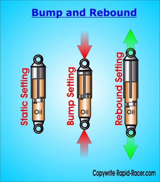

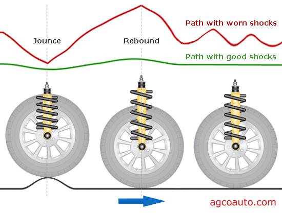

The rebound is the collapse. The extension is the hit when in separation.
I've always seen 'rebound' as what you call 'extension' (which I never heard). The opposite - what you also call 'collapse' - has many names though, such as 'bump', 'compression' or 'jounce':
But I still have a theory to explain the phenomena even with stiffening up the compression instead of the extension! Before, your rear end collapsed rapidly under the weight transfer. By stiffening up the shock, the process doesn't go as fast and the ##cg## remains high longer, therefore permitting more weight transfer.
OK. I'll get on the correct terms.
I stiffened the bump or collapse. The rebound is half as it always was.
