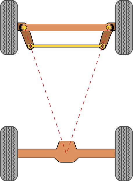

Steering can be quite a complex topic so I would like to keep it as simple as possible. As I read about it, many terms such as slip angle, camber, toe, and bump steer among others came up. For this first and simple iteration, I like to just focus on Ackerman steering and other similar alternatives such as Bell-crank steering.
The following is the typical picture of Ackerman steering geometry. As shown in it, the center of the turning circle is crystal clear in the picture.
Diagram of Ackermann steering geometry: at top, a front axle with two steered wheels linked by a trapezoidal arm, and dashed lines from each wheel converging at the centre of the turning circle; below, a top-down view of a car with a rear axle, both wheels, and the same centre of turning circle on the dashed line.
My problem with such a solution is that the shown situation only happens at a particular steering angle. Is that right? I tried some drawings and it's what I seem to obtain from them. For all other angles, the intersection of those three lines will not be at the same point.
In the case of an Ackerman geometry, the mechanism is just a 4-bar linkage. I wrote some equations to find out if it's possible to design it with such a size ratio so that the intersection happens as in the picture independently of the steering angle but solving the equations is turning out more difficult than initially expected.
Can you confirm if it's possible to design it in such a way as to guarantee the three lines always intersect at one point?
If it's not possible, what's the best approach? To design it so that at full steering angle that condition is fulfilled? Or maybe at half the steering angle because it will occur more frequently?

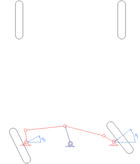

By the way, I will most likely use a Bell-crank steering because it seems more compatible with a servo but I initially focused the point on the Ackerman mechanism because it's simpler so I'd like to try to understand that one first.
Schematic of a front steering linkage with two wheels shown as outlines, a red four-bar style linkage between two pivots labelled with angles θ2 and θ1, and a blue pivot with a fixed ground symbol in the centre.
https://en.wikipedia.org/wiki/Ackermann_steering_geometry#Design_and_choice_of_geometry said:
Design and choice of geometry
A simple approximation to perfect Ackermann steering geometry may be generated by moving the steering pivot points inward so as to lie on a line drawn between the steering kingpins, which is the pivot point, and the centre of the rear axle. The steering pivot points are joined by a rigid bar called the tie rod, which can also be part of the steering mechanism, in the form of a rack and pinion for instance. With perfect Ackermann, at any angle of steering, the centre point of all of the circles traced by all wheels will lie at a common point.
Modern cars do not use pure Ackermann steering, partly because it ignores important dynamic and compliant effects, but the principle is sound for low-speed maneuvers. Some racing cars use reverse Ackermann geometry to compensate for the large difference in slip angle between the inner and outer front tires while cornering at high speed. The use of such geometry helps reduce tire temperatures during high-speed cornering but compromises performance in low-speed maneuvers.
Top-down diagram of a car steering linkage: four wheels, a front axle with an upper cross bar and a yellow tie rod, and red dashed lines converging toward a point on the rear axle.

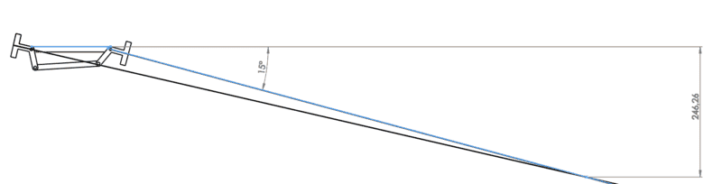

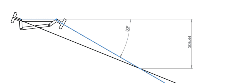

I did read that page and tried drawing it but then the mechanism didn't do as promised. Or at least, I didn't see it doing as promised.
In the following pictures, you can see how the vertical distance is not preserved for different steering angles. Therefore, it doesn't matter at which distance I place the rear axle, only at a particular steering angle I will have the 3 lines intersecting at a common point.
Simple line drawing of a steering linkage: a rectangular axle-like bar with two vertical ends, connected by angled links to a trapezoidal lower linkage, with a long horizontal line extending to the right.
Side-view CAD sketch of a car steering linkage with a black line and a blue line meeting a shallow sloped line, a 1.5° angle marked, and a vertical dimension labelled 246.26.
CAD sketch of a car steering linkage with a black and blue line from the front axle toward the lower right, a 30° angle arc, and a vertical dimension of 206.44 between horizontal reference lines.
If that vertical distance was preserved, I could place the rear axle there so turning shouldn't require slipping (or as much slipping). But I don't see how that's the case.
I then wrote the equations that describe that vertical distance (206 and 246 in the previous pictures) to see if it's possible to size the bodies so that it's independent of the steering angle but I haven't solved the system yet. I would need to code something to solve it and I'm not even sure if there exists a solution independent of the angle.
Ackerman steering is not exact, but it is a good enough approximation for real vehicles.

Does a Bell-crank steering have the same limitations?
Is there a better mechanism that can really guarantee that, at any angle of steering, the center point of all of the circles traced by all wheels will lie at a common point?
