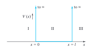

For context about where in the calculations I am, we assume that a particle is subjected to a potential energy function that is infinite everywhere along the ##x##-axis except for a line segment of length ##l## where the potential energy is zero.
Thus, the ##x##-axis is divided into three regions where we will solve Schrödinger's equation
It can be shown that in regions I and III, the solution to (1) is just ##\psi(x)=0##.

There is one other condition: the particle has to be somewhere, so ##\int \psi^* \psi =1##
Right, so this is what effectively prohibits the solution ##\psi(x)=0##.
There is no problem with the solution ##\psi(x)=0## for the Schrödinger equation in the purely mathematical sense, it is trivial however. On the other hand, physical solutions must always be *normalizable*, i.e. $$\int^{+\infty}_{-\infty}\psi^{*}(x)\psi(x)\;dx.$$
Some kinds of non-normalizable states are particularly repugnant, e.g. states like: $$\int^{+\infty}_{-\infty}\psi^*(x)\psi(x)\; dx\gt\infty,$$
however, states like the one under consideration ##\langle\psi(x)|\psi(x)\rangle=0## are not so incorrigible, i.e. one can think of them as solutions referring to particles that do not exist. But this is after all physically meaningless in that it makes no sense to talk about things that do not exist. In the spirit of the great Henri Poincare, it is good scientific philosophy to pursue only those things which are useful.
