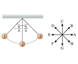

To understand that the direction of acceleration is in the direction of the change of the velocity, which is unrelated to the direction of the velocity.
The pendulum shown makes a full swing from -pi/4 to + pi/4. Ignore friction and assume that the string is massless. The eight labeled arrows represent directions to be referred to when answering the following questions.
What is the direction of vector A when the pendulum is at position 1?
What is the direction of vector A at the moment the pendulum passes position 2?What is the direction of vector A when the pendulum reaches position 3?
I have no idea what equations I should be using here...I am very stuck and could use some hints to steer me in the right direction.
All I know so far is that the acceleration is equal to the instantaneous rate of change in velocity.

Hi ScullyX51! :smile:
ScullyX51 said:
What is the direction of vector A …
I'm really confused …
is "vector A" the A in the picture, or is it the acceleration? :confused:
yes. I was very confused by that as well...but I am pretty sure vector a is referring to acceleration.
ok … then the question is asking where the acceleration is when something moves in a circle.
You can work this out using r and θ, or i and j, or just by drawing a little triangle where two sides are the velocities at angles θ and θ + dθ, and the third side is the change in velocity. :smile:
