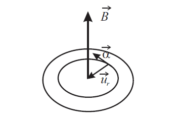

There's a disc with a current density surface σ, with radius R and angular velocity ω
Diagram of two concentric circles lying flat, with a vertical arrow labelled B at the centre and a radial arrow labelled u_r pointing outward, plus a slanted arrow labelled alpha between them.
Find the B
α = vσ=ωrσ

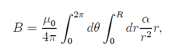

I'm having problems understanding why the cross product gives αr
Equation B = (μ0/4π) times the integral from 0 to 2π of dθ times the integral from 0 to R of dr (α/r²) r, written in LaTeX-style typeset math.
## \vec{u_r} ## is a unit vector. The cross product ## \vec{\alpha} \times \vec{u_r} ## is simply ## \alpha \hat{z} ##. Write out the expression for ## dS' ## in terms of ## dr ## and ## d \theta ## and I think you will see where the "r" in the numerator comes from. Also, express ## \alpha ## in terms of ## \sigma ## and ## r ## and ## \omega ## . (## \alpha ## is not a constant). ## \\ ## editing... Your diagram is hard to read, but I see the disc extends out to radius R. (I initially thought the disc goes from ## R_1 ## to ## R_2 ##.) ## \\ ## Once you get these steps in place, you can then evaluate the integrals.
