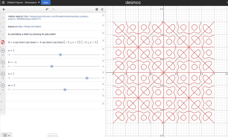

Possibly useful:
https://thelig.ht/chladni/
https://www.desmos.com/calculator/vmp1kbn9ml
  • You can modify the rate of the slider animation (e.g. to slow it down) using the Properties button below each play button.
  • Zoom in to a region to see a more fluid animation.
  • variant: https://www.desmos.com/calculator/rcwjdw5i1o
