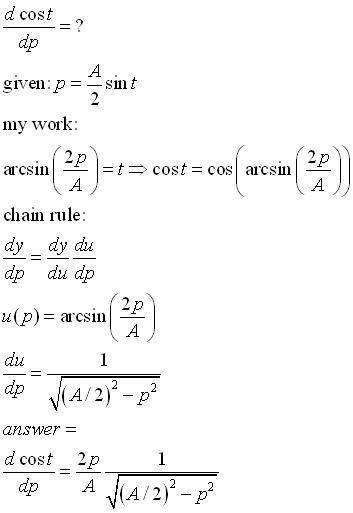

This is a problem and i show you my work, what i don't understad is how to differentiate things like:
d(cos(t)) / dp
is all i have done so far madness? or where iam i doing wrong?
(i did not got the answer myself)
I can't see your attachment (it's not been approved yet) but to perform that derivative, you use the chain rule. So
[tex]\frac{d}{dp}(\cos t)=-\sin t\frac{dt}{dp}[/tex]
In the attachment, you are also given that p= A/2 sin t so that t= arcsin(2p/A)
You calculation looks correct except that you have forgotten the "-": d(cos(t))/dt= - sin(t) so -sin(arcsin(2p/A)= -2p/A.
