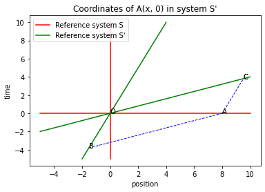

In the figure, the event A is simultaneous to B in the reference frame S' while A is simultaneous to O in the frame S. (The line of simultaneity is obtained by drawing a line parallel to the X axis of the reference system).
Event ##A\equiv (x,0)_S=(\gamma x,-\gamma \frac v {c^2}x)_{S'}##
Event ##B\equiv (-{\gamma}^2 {(\frac v c)}^2 x,-{\gamma}^2 \frac v {c^2}x)_S=(0,-\gamma \frac v {c^2}x)_{S'}##

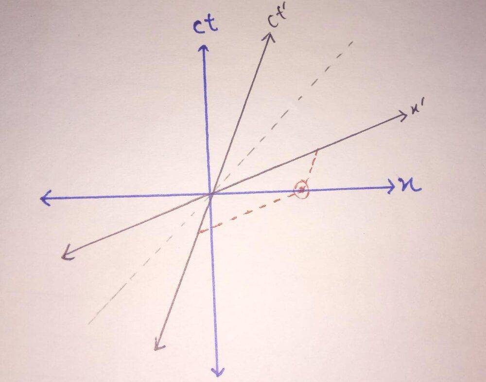

I'll try to visualize what happens through spacetime diagrams.
I imagine the event happening at some (x,0) in S frame.
This means that the light coming from the event reached origin of S at t=0 and the observer there noted the position as x.
The diagram says that:
In S' frame, the light reached the origin faster and since it was far behind, the position noted, x' was also greater than x.
But why did the light from the event reach S' faster? The origin of S' has not even crossed the origin of S yet, and the light should have passed the observer closer to it first.
Please explain me in terms of light.
