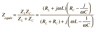

I should have listed these references earlier to see if they can be of any help.
Starting here: http://hyperphysics.phy-astr.gsu.edu/hbase/electric/imped.html"
click on http://hyperphysics.phy-astr.gsu.edu/hbase/electric/rlcpar.html#c1"
where you can find the impedance of the parallel branches combined in the same way that "parallel resistors combine"
where
and
and the "Complex Impedance Method".
or
You can use this calculator for grins.
http://hyperphysics.phy-astr.gsu.edu/hbase/electric/rlcparc.html#c1"

But looking back at dlgoff's post and about being able to use the formula
So in my case branch 1 is just a resistor and branch 2 just a capacitor.
So that would make Z1 just R, and Z2 just Xc.
So it would go back to just 1/Z = 1/R + 1/Xc
but I have been given the formula
z = R*(Xc) / sqrt((R^2)+(Xc^2))
Which again, is my original question...:( haha arhggggg

yes (though dlgoff's formula is a far more general one, dealing with series resistors also, and an inductor) :smile:
You lost me a bit with
V = Itotal/(1/R + jωC)I)
SO the final formula, is the bottom squared and then rooted just to get rid of the -j?
No, we're not "getting rid of" the j part,
we're finding the magnitude (modulus) of the whole thing. :wink:
ahhhhhhhhhhhhhhh. It worked! Doing it the very long way using complex numbers for both R and Xc and putting it into my second formula.
Then with the complex number answer, use it to get the modulus and the phase.
So even though bits are choped off, they are still there, like the 1cos(x) = cos(x) example.
for example, everything has an impedance but if a certain part is 0 its just written as the part with the number. So R = just the real part.
..So even though its not like that, I like to understand it that way just so I can see what is going on, and then from there I can see how and where bits go away etc
So now I am going to see if I can work it the same to get to the first formula
p.s, So impedance, as a complex number, what does the real and imaginary part represent? So a resistor as 0 imaginary part...it has 0 what?...My guess 0 reactance? So real is resistance due to power loss? and imaginary "resistance" based on frequency (based on phase shifts?)?
