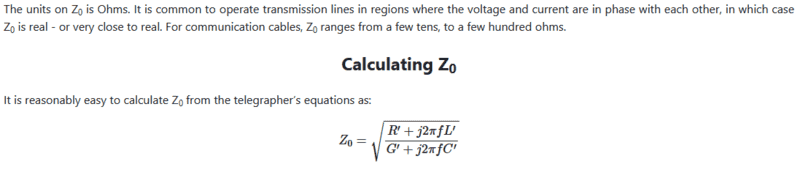

##Z_0## is well defined in the literature, and I use it every day. One way to measure the ##Z_0## of a TL with length of a couple of wavelengths is to connect a potentiometer at the end and turn the little dial thing until there are no reflections for an input waveform drive. There are no infinities involved in that measurement, no?
berkeman said:
Mainstream textbook reference please.
https://web.mst.edu/~kosbar/ee3430/ff/transmissionlines/z0/index.html

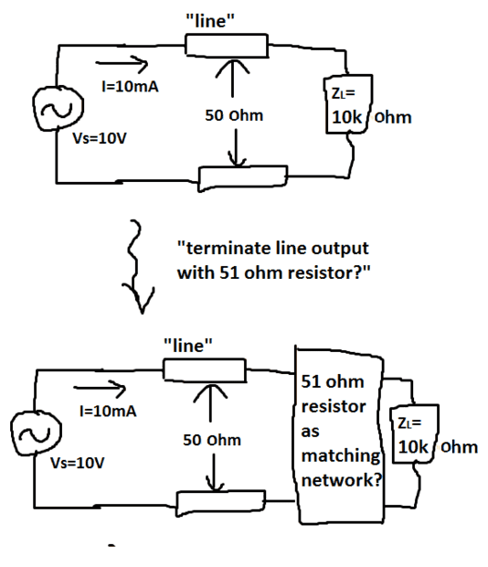

Baluncore said:
Say you have a ±10V signal from an op-amp with a 10 mA output current limit, driving a module having a 10k ohm input resistance. You want to use a short 50 ohm line for the job.
If you terminate the line output with a 51 ohm resistor, the op-amp will need to deliver 10V / 50R = 200 mA. But the op-amp can only deliver 10 mA, so it will require a 200 mA line driver. Then 99.5% of the power will end up in the termination resistor. That is a waste of money, energy, and PCB real-estate.
If instead you ignore the matching, the line will look like a low-pass network, which you can make look to the low impedance op-amp output, more like the 10k load.
Sorry for my dumbness but I'm sure if I understand your example. What you mean by the formulation
"terminate the line output with a 51 ohm resistor"?
What is this 51 ohm resistor? Does it play the role of a "matching device" in following sense:
Or do you have another configuration in mind?
Yes, if you want to fix the large mismatch between the 50 Ohm TL and the 10k Ohm load, you would use a matching network that has 50 Ohm input impedance and 10k Ohm output impedance.
But this is obviously a bad thing to do, and the whole system should be re-engineered to make it work better without dissipating lots of un-needed power. Driving a 10k Ohm load with a transmission line would probably not be the way that you would handle that situation in real life. More likely you would use a low-power 50 Ohm TL with a separate low-power amplifier at the output to drive the high-Z load.
...And the "line resistance of 50ohms" plays here also then exactly the role
of "source impedance", right? (because the way how I understand the classical
impedance matching problem in usual/general setting
is reflected in the picture here: https://en.wikipedia.org/wiki/Impedance_matching
the source should "have" impedance, and the only parameter in Baluncore's
example coming into question for this "source impedance" ##Z_S## seems to be
this 50 ohm line.) In other words there are no some "additional" impedances on the source side given such that ##Z_S## arise as "total" impedance of these partial imps AND the line impedance of 50ohm? So this 50ohm line impedance is the only involved impedance contributing here to ##Z_S##, right? Or do I mixing here something up?
Baluncore was illustrating how the concept of "impedance matching" can be misused if you don't consider the whole system. A low-power opamp can drive a 10k Ohm load no problem (up to the output voltage constraints of the opamp), so it would be strange to put a long 50 Ohm TL between the opamp and the 10k Ohm load to propagate the opamp signal to the load (a long enough TL so that at the frequencies of operation the TL characteristic impedance comes into play*).
A low-power opamp is not designed to drive a 50 Ohm load (you use a buffer amp for that), and a 10k Ohm load is not usually placed at the end of a 50 Ohm TL all by itself, since it's badly mismatched. Instead, if you were designing a system where an opamp output were driving a 10k Ohm load over long distances, you would use a buffer amp at the far end to preserve signal integrity and not waste boat-loads of power.
* And low-power opamps only have a bandwidth of 100kHz or so (a little more for the more expensive opamps), so any TL that was a couple wavelengths long would have a lot of resistive loss.
