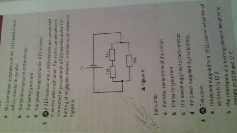

If you look ag question 3c you can not use all the formulas. Only one will give you the right answer.
What are the knowns and what are the unknowns? Which formula fits?

P=v`2/r
Gajan1234 said:
P=v`2/r
This gives me the wrong answer
What numbers did you use?
Well I can use the P=v^2/R formula but it gives me the wrong answer
P=6^2/9
Gajan1234 said:
P=6^2/9
Why did you use "6" for volts? The picture's not that clear, but doesn't it read "3"?
