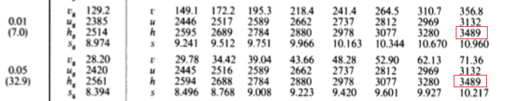

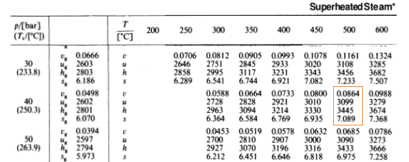

From the question superheated steam at a pressure of 40 bar and a temperature of 500°C would fall into this highlighted catagorie of the steam tables, and I am looking at the Enthalpy (the amount of internal energy required to conver 1kg of water to 1kg of steam) so I get 3445 kJ kg^-1
In my notes I have the the Thermal Efficiency (TE) = (h_1 -h_2)/(h_1-h_3)
h_1 i believe is 3445 kj kg^-1
h_2 is the Specific Enthalpy after the steam leaves the turbine and enters the condenser, so I am looking at the 0.03 bar pressure at 500°C and I understand I should use Interpolation to find the figure at 0.03 as the given figures are 0.01 to 0.05.
but I can see it is unchanged from the highlighted 3489 kJ kg^-1

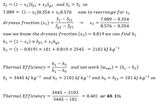

The entropy change is supposed to be zero in the turbine.

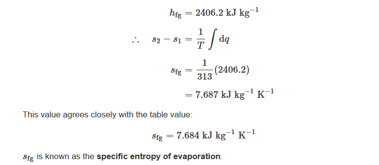

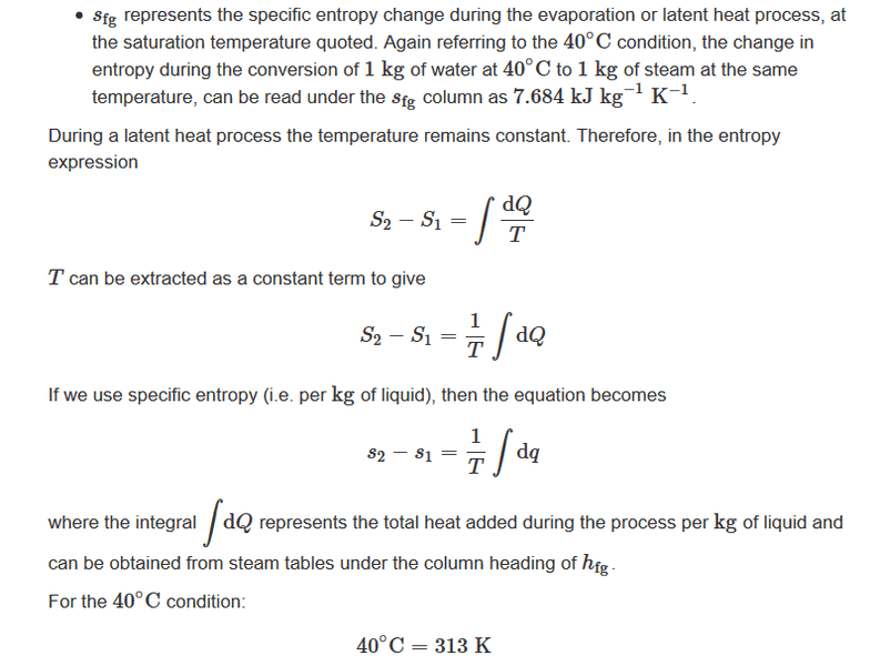

I am confused because if I go to the extract in the steam tables at approximately 20deg (19.95deg from the above solution)
Temp Pressure Volume Specific Enthalpy SE Steam(hg) S Entropy S Entropy
Water(hf) Water(Sf) Steam(Sg)
SE Evaporation(hfg) SEntropy Evap(Sfg)
I Hope the above headings make sense...
My entropy method looks correct at 8.684 but the change in entropy is different. Now the superheated steam is now cooled am I dealing with Enthalpy (hfg)?

Al_Pa_Cone said:
I am told the procces has very little heat loss through the turbine therefore the temperature is constant.
This is definitely NOT CORRECT. The turbine is doing work, so there is a huge decrease in enthalpy (at constant entropy, as I said), and a corresponding large decrease in temperature. The temperature exiting the turbine is 24 C, and the water is a combination of saturated liquid and saturated vapor; and h2 is about 2000 kJ/kg.

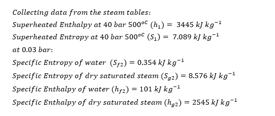

This is what I have come up with as an answer can anyone verify this? my next question is based on the same method and working out as this one and I need to know if I have slipped up or not as I will repeat the problem next time.
Thanks
