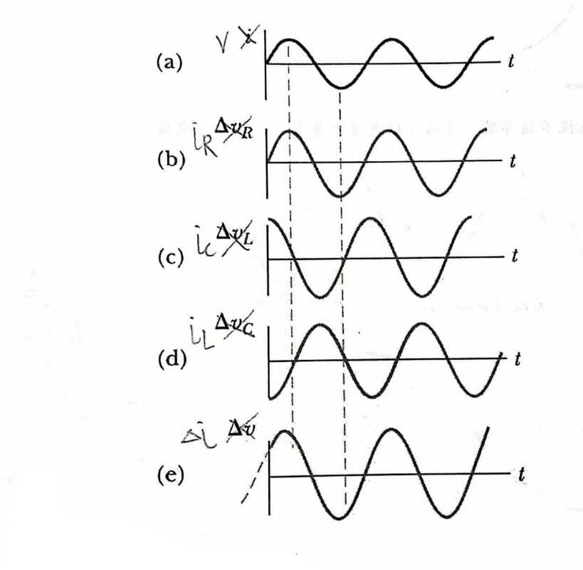

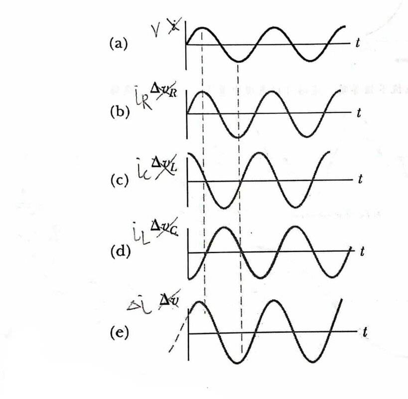

As attached, I replaced the symbols of y axes that was used to represent RLC circuit in series, and now the graphs are for RLC circuit in parallel. I'd like to make sure I understand what you stated. thanks.
I think it's OK. But there's no real way for me to say for sure, since you never defined what those variables are. In particular polarity. Is your inductor current pointing up, down, left, right? Plus I have absolutely no idea what ΔIL is. If you are going to show mathematically functions to describe circuit parameters, you must clearly define what those labels mean, or nobody will know what you are talking about. Circuit questions should always include a schematic diagram with variables labeled (particularly polarities).
Also, you include a 4th current ΔIL, which appears to have a small phase shift from the 0, π/2, π, -π/2 values. I don't understand how this applies to a parallel RLC circuit. You need to explain your problem as well as your answer. Otherwise we will assume it's the normal, most common, form, which, in this case, has no ΔIL (as I would define it).
