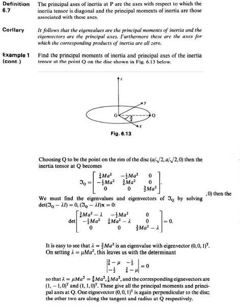

I do not understand how the vector (1 -1 0)T represents the axis tangent to the disk at Q.
Textbook page with Definition 6.7, a Corollary and Example 1 on principal axes of inertia; Fig. 6.13 shows a disc with centre G, rim point Q, and x, y, z axes drawn from G.
Tried thinking in terms of simple vector addition, but just got another vector in the radial direction...
I mean, (1 -1 0)T is parallel to a tangent vector to Q, is that sufficient ?

I don't really understand what's worrying you. :confused:
don't "the axis tangent to the disk at Q" and "parallel to a tangent vector to Q" mean the same thing?

Hello tiny-tim!
Apparently I was a bit rusty with vectors and was not sure if we are free to translate to parallel vectors on top of each other, but thanks !
