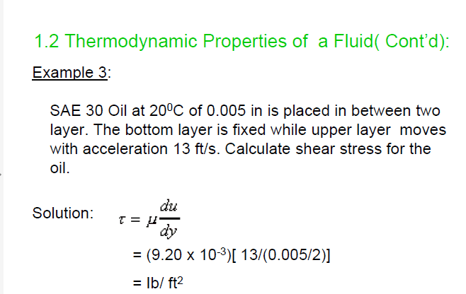

goldfish9776
310

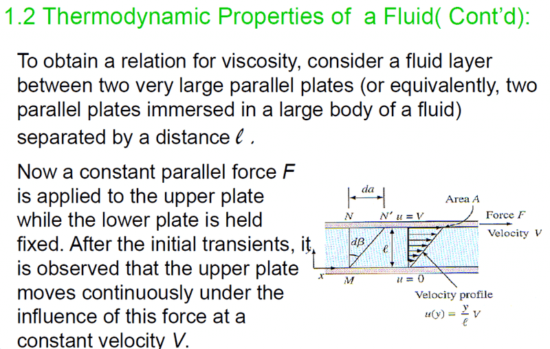

for the second photo , why the dy is 0.005/2 ? why not 0.005 ?

Looks like a mistake to me. Also, it says acceleration where it means velocity.
In your opinion , it should be 0.005 ?
Yes.
