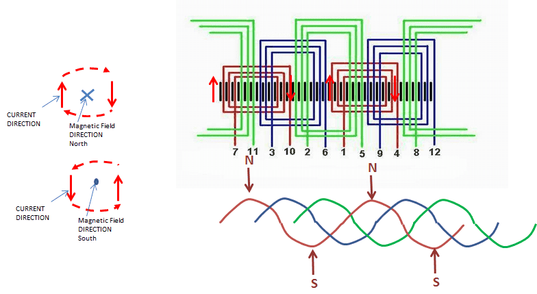

I've studied a 2-pole IM with its winding diagram and understood how the two poles are formed. But I'm struggling to understand the same thing about a 4-pole motor.
How does this winding arrangement result into 4 poles?
I think it is the same explanation. See the sketch.
