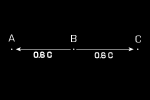

I'm trying to understand the special theory of relativity. All answers I've found to the problem below seem to provide an inadequate answer. Could anyone answer this question?
A rock in space at position B explodes into two halves (A & C) in such a (hypothetical) way that each half moves away from position B at a constant speed of 0.6 x the speed of light. Regardless of what anyone in any position might observe, how fast is A moving away from C?
Is it 1.2c, and if not, aside from the fact that we're simply told that an object cannot move faster than the speed of light, why can't A be moving away from C at 1.2c? or can it?

yeah, as you suspect, it is not possible for them to explode away from each other at relative velocity of 1.2c. A simple way to realize why this is impossible is to think of the case when they explode away from each other at some relative velocity very close to c, yet still less than c. OK, so thinking about the observer looking at the stationary rock at position B: If he puts some dynamite inside the rock, then this energy released by the explosion will be converted into the kinetic energy of the two halves as they fly away from each other, right? And so here is the critical bit: the more dynamite you use, the more kinetic energy the two halves will have, right? So you might intuitively think that you can add so much dynamite that the two halves will fly away at greater than c. But, this is not the case, because it takes an infinite amount of energy to make the two halves fly away from each other at c. More precisely, you could keep adding more energy to your dynamite pile, and therefore the two halves would have arbitrarily large kinetic energy. But still, their relative velocity will be less than c.
In short, no matter how much dynamite you use, and how much kinetic energy you give to the two halves, this will still correspond to a relative velocity which is less than c.

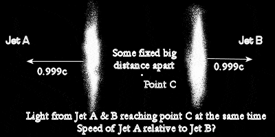

In reference to http://www.space.com/694-blazing-speed-fastest-stuff-universe.html
A blazar gas jet (Jet A) shoots out from a blazar at close to the speed of light (0.999c). A fixed distance away from the first blazar, a second blazar shoots out a blazar gas jet (Jet B) in the opposite direction at close to the speed of light (0.999c). These events happen simultaneously in the universe in the sense that if an observer was mid way between the jets then light from the tip of the jets would reach him/her at the same time.
Although someone couldn't witness or measure the two jets moving away from each other at close to twice the speed of light (due to the time it takes the light from each to reach a common measuring device), could we not deduce that given we know how far apart the blazars are, how fast blazar gas jets move, and which direction they were pointing in, that Jet A moved away from Jet B at close to twice the speed of light?
If not, given the assumption that it is possible for two blazar jets to exist in the universe at the same time, pointing in opposite directions, and that blazar jets can move at close to the speed of light, how do we conclude that they aren't moving away from each other any faster than the speed of light? or are they?

In relativity, we use a special formula for combining two velocities - you don't just add them together! This formula guarantees that the result will always come out less than c.
If you are "stationary" at point C, in your reference frame the two jets are separating at a rate of close to 2c. Relativity has no problem with this, because this is not the velocity of any object in any reference frame.
If you are "riding along" with either jet A or jet B, in that reference frame the other jet is moving with a velocity whose magnitude is very slightly less than c, according to the relativistic "velocity addition" formula that Bill K pointed you to.

The correct addition formula is [tex]v_{rel}=\frac{v_1+v_2}{1+\frac{v_1v_2}{c^2}},[/tex] Plugging in the values [tex]v_1=0.6c,[/tex] and [tex]v_2=0.6c,[/tex] we get [tex]v_{rel}=\frac{0.6c+0.6c}{1+\frac{(0.6c)(0.6c)}{c^2}}=\frac{1.2c}{1+0.36}=\frac{1.2}{1.36}c=\frac{15}{17}c.[/tex] Clearly that is still less than the speed of light.

In the usual approach to special relativity everything is based on two postulates:
1) the laws of physics are the same in all inertial frames
2) the speed c is the same in all inertial frames
From those two postulates you can derive the Lorentz transform and from the Lorentz transform you can derive all of the other special relativistic effects.
