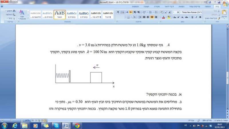

suppose I have a horizontal problem where I have a spring attached to a wall, a body that moves toward it in some inital speed and the surface isn't smooth so I have friction along the surface towards the spring and also while the body contracts the spring. I'm asked what's the maximal contraction? I get 2 values for Xmax: one positive and the other negetive (also different in absolute value). One of them is 0.149 m and the other is -0.208. How can I know which one represents maximal contraction and which one represents maximal strechning?
this is a general question - never mind the specific values of k, mue(k), distance from spring at which body starts from with vo etc...

the axis isn't my choice - I uploaded the question - I still don't get what difference does it make... i didn't need to consider the axis direction all along the problem: not for calculating fk, not for calculating the work fk does (which is -mue(k)mg(1+Xmax) where 1 is the distance from where m has v0 of 3 m/s (starting point) to the edge of the spring) so as far as I see it, until this point I could have done this prob without even drawing the positive direction of the x axis...

Yes, but when you write your energy expressions you are making an assumption about what a positive value of displacement represents. Given your choice, does a negative value for displacement make sense?
Honestly i don't know... I would think that maybe if the positive direction of x-axis is to the right then for contraction (which is to the left) i would in fact want a negative value, but if i would have chosen the positive axis to the other side i still would have goten the same values for Xmax with the same signs, because the x-axis direction didnt affect my calculations at all... I am confused

Well actually, that's just what you did when you wrote your equations! You assumed increasing x going to the left. Otherwise your friction term would have to have the opposite sign, and you would expect the result to be a negative value for x. This is what I mean about assumptions being made, whether or not you make them consciously.
Note that it's okay to write equations without slavishly adhering to an initial choice of coordinate axes provided that you understand the relationships between the quantities that you're using and the way they each behaves with the "impromptu" choice of axes. You will gain comfort with experience.
Now, suppose that you consider for a moment what it would mean if you chose the negative solution. Would that correspond to a compression or an extension of the spring? How could the spring become extended before the body even reaches it?

Your solution would not have been correct if you were told explicitly to assume the x-axis is to the right. After all, your initial velocity would then have to be negative, and your friction term would have to account for friction loss increasing as x decreases. The math would have been complicated by an imposed choice.
You simplified your life by making an intelligent choice of axis orientation and origin, which made the math simpler. But it's up to you to understand what the implications are of the choices you make and to interpret the results in terms of "physically possible".

But as you see from what i uploaded they chose x to be positive to the right... Can you please solve the problem for the positive to right x axis? I think it all would be clearer to me if ill see the other solution

If you want to pursue the "enforced choice of axes" solution, I can help you. The first thing to do would be to make explicit your choice of axis by stating the direction and origin, then locate the important positions along the axis (like the initial position of the mass, and the position of the relaxed spring. A clever choice of origin will help.
Regarding the "specious" negative solution to your original method, note that in reality the physics of the problem changes when the mass reaches the spring; it is only then that the potential energy of the spring comes into play. The equation you wrote made the assumption that the mass had reached the spring, having shed some KE to friction on the way. But as you put it, the math doesn't know this. It could equally well represent a situation where the mass is moving in the other direction and remains attached to the spring, thus stretching it while gaining KE from friction! This is not a physically viable solution, doesn't represent what you intended, and so should be discarded. But it's up to you to recognize this, since you're writing and interpreting the equations.
