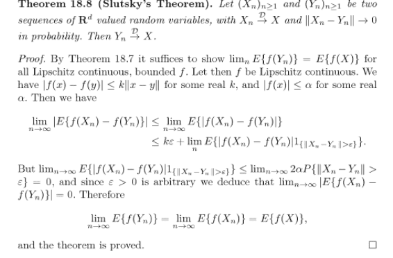

I want to know how this proof works, but there are several things I don't understand.
(1) How does the ##k\epsilon## appears? ##k## is the lipschitz constant, but what about ##\epsilon##? Is the author taking ##||x-y||<\epsilon##?
(2) What does the subscript ##1_\{||X_n-Y_n||>\epsilon\}## means and why is it there? I think the author divided the those values who were at a distance smaller than ##\epsilon## and those who weren't, but I'm not completely sure about this.
(3) Why is it ## E\{|f(X_n)-f(Y)n|1_{||X_n-Y_n||>\epsilon}\}\leq 2\alpha P\{||X_n-Y_n||\}##? This might be related to my second question, I am not completely sure about the meaning of the subscript. I see ##f## is bounded by ##\alpha##, but why is it ##2\alpha##?
I'm not sure, but I believe so.
It's the characteristic function for that set. In this case, it evaluates to 1 on the set where ##||X_n - Y_n|| > \epsilon##. The function evaluates to 0 on the complement of this set. See https://en.wikipedia.org/wiki/Characteristic_function_(probability_theory).

My guess: We have ##|f(x)| < \alpha## due to the Lipschitz continuity, so ##|f(x) - f(y)| < 2\alpha##.

Thank you. In regard to the comment about Lipschitz continuity, isn't ##k## de Lipschitz constant? And what kind of inequality justified the change from expectation to probability in (3)?

The author splits up ##E|f(X_n)-f(Y_n)|## into two parts: (i) the part where ##|X_n - Y_n| < \epsilon## (so that the expectation on that part is ##< \epsilon k## because we have ##|f(X_n) - f(Y_n) | \leq k |X_n - Y_n| < k \epsilon##); and (ii) the part where ##|X_n - Y_n | > \epsilon##, over which we have ##|f(X_n) - f(Y_n)| \leq |f(X_n)| + |f(Y_n)| \leq 2 \alpha##, so that the expectation on that part is ##\leq 2 \alpha## times the probability of that part.
For avoidance of doubt and confusion: do not call that a "characteristic function".
For probability purposes: things like ##\mathbf 1_{\{X \leq x\}}## or ##\mathbb I_{\{X \leq x\}}## are referred to as Indicator Functions.
In most branches of math we could call this a characteristic function -- not so in probability (and stats). In probability a 'characteristic function' is a reserved term and only used to refer to a kind of transform (basically a Fourier transform). If you look at the link provided by @Mark44 you can verify this for yourself.
