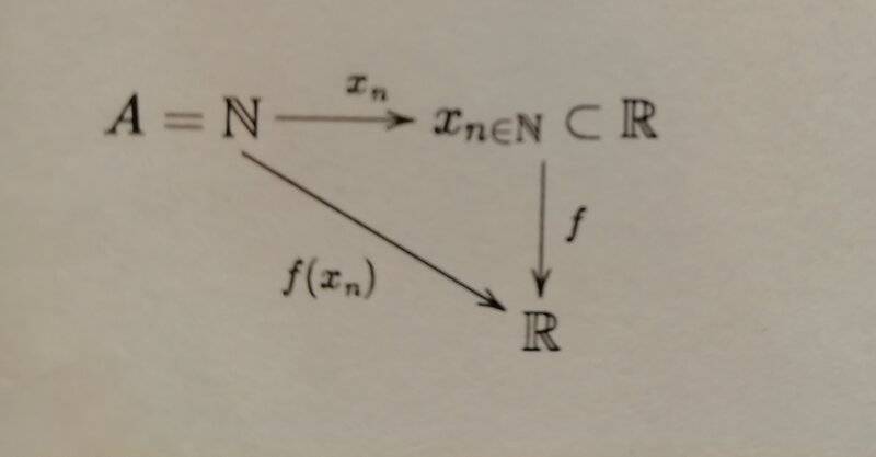

I've got a piecewise function, and wanted to demonstrate its continuity using sequences
##f(x)=\begin{cases}{\left|{x}\right|}&\text{if}&x\in\mathbb{Q}\\0&\text{if}&x\not\in\mathbb{Q}\end{cases}##
I've been given the proof, but don't understand; to calculate the limit of ##f## when ##x## tends to zero it's enough to see that if ##\{x_n\}_{n=1}^\infty## is a sequence that tends to ##0##, then $$f(x_n)=\begin{cases}{\left|{x_n}\right|}&\text{if}&x\in\mathbb{Q}\\0&\text{if}&x_n\not\in\mathbb{Q}\end{cases}$$ clearly tends to ##0##. Hence, ##\lim_{x\to 0}f(x)=0##
Question: why ##f(x_n)## tends clearly to zero?. I know I've already answered it on this post, but I don't understand.

What is your definition of a convergent sequence? You should use that to prove that ##f(x_n) \rightarrow 0## as ##n \rightarrow \infty##.

To evaluate the limit of ##f## when ##x## tends to ##0## just notice that if the sequence ##\{x_n\}_{n=1}^\infty## tends to ##0##, then
##f(x_n)=\begin{cases}{\left |{x_n}\right |}&\text{if}& x_n \in \mathbb{Q}\\ 0 & \text{if}& x_n \not \in \mathbb{Q}\end{cases}##
This is not the proof. I've been searching for the way to calculate it, but haven't found anything.
To prove that converges to zero, what do you have to prove?

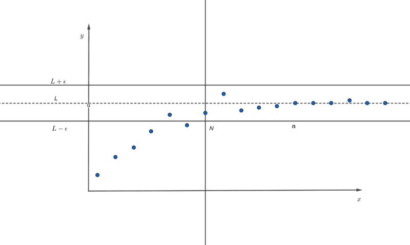

Hi, take this as something speculative, for I'm just guessing.
Let ##\epsilon>0##. We choose ##N\in\mathbb{N}## such that ##N>\dfrac{1}{\epsilon}##. Such a choice is always possible by the Archimedean property. To verify that this choice of ##N## is appropiate, let ##n\in{\mathbb{N}}## satisfy ##n\geq{N}##. ##n\geq{N}## implies ##n>\dfrac{1}{\epsilon}##, which is equal to ##\dfrac{1}{n}=\Big| f(x_n)-f(0)\Big|<\epsilon##, proving that ##\{a_n\}_{n=1}^\infty## converges to zero by the definition of convergence.
Graph of a sequence of points plotted against x, approaching a horizontal dashed line at L, with horizontal lines at L + epsilon and L - epsilon and a marked index N on the x-axis.
Let ##\epsilon>0##. We choose ##N\in\mathbb{N}## such that ##N>\dfrac{1}{\epsilon}##. Such a choice is always possible by the Archimedean property. To verify that this choice of ##N## is appropiate, let ##n\in{\mathbb{N}}## satisfy ##n\geq{N}##. ##n\geq{N}## implies ##n>\dfrac{1}{\epsilon}##, which is equal to ##\dfrac{1}{n}=\Big|\f(x_n)-f(0)\Big|<\epsilon##, proving that ##\{a_n\}_{n=1}^\infty## converges to zero by the definition of convergence.
Start this way:
Let ##\epsilon \gt 0## and the sequence ##\{x_n\}^{\infty}_{n=1} \rightarrow 0##. Then there is an ##N \in\mathbb{N}## such that ##|x_n| \lt \epsilon, \forall n \gt N##.
Continue from there.

Hi, PF, d) step is what we want to prove; it is a consequence of e) step;
##\xymatrix{ A=\mathbb{N}\ar[r]^{x_n} \ar[dr]_{f(x_n)} & x_{n\in\mathbb{N}}\subset \mathbb{R}\ar[d]^f \\ & \mathbb{R} }##
I've been given the proof for an arbitrary sequence:

mcastillo356 said:
Hi, PF, d) step is what we want to prove; it is a consequence of e) step; $$\xymatrix{ A=\mathbb{N}\ar[r]^{x_n} \ar[dr]_{f(x_n)} & x_{n\in\mathbb{N}}\subset \mathbb{R}\ar[d]^f \\&\mathbb{R} }
The line above (with the $ pairs removed) doesn't render correctly. I have no idea what you're trying to say in that line.
mcastillo356 said:
PF, please, check the LaTeX.
I tried, but I don't know what you're trying to say.
Commutative diagram: A = N with arrow x_n to x_n in N, subset of R; arrow f from that set down to R; diagonal arrow labelled f(x_n) from N to R.
Hi, PF, @Mark44, I wanted to explore every step carefully. The goal was to ensure that we have a composition of functions of the real numbers in the real numbers and eventually ensure the prevalence of step D over E.
This doesn't make any sense to me. I think you are making this all more abstract than it should be.
