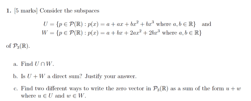

Understanding the solution to this subspace problem in linear algebra
2 replies · 1K views
MaxJ
Below
Below
For this problem,

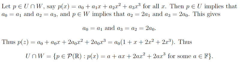

The solution for (a) is
I am slightly confused for ##p \in W## since I get ##a_3 = 2a_1## and ##a_2 = 2a_0##. Since ##a_3 = 2b##, ##a_2 = 2a##, ##a_1 = b##, ##a_0 = a##.
Anybody have this doubt too?
Kind wishes
I agree with your conclusion and assume that whoever wrote what you attached made a typo. Further evidence is that the author also wrote "Thus p(z) ..." when clearly p(x) was intended.

I got the same result as claimed:
\begin{align*}
a+ax+bx^2+bx^3&=\lambda c+\lambda dx+2\lambda cx^2+2\lambda dx^3\\
c&=\lambda^{-1}a\\
d&=\lambda^{-1}a=c\\
a+ax+bx^2+bx^3&=a+ax+2ax^2+2ax^3\\
b&=2a \\[6pt]
U\cap W&=\{a(1+x+2x^2+2x^3)\,|\,a\in \mathbb{F})\}
\end{align*}
but I get confused with the ##a_i## in the book.
