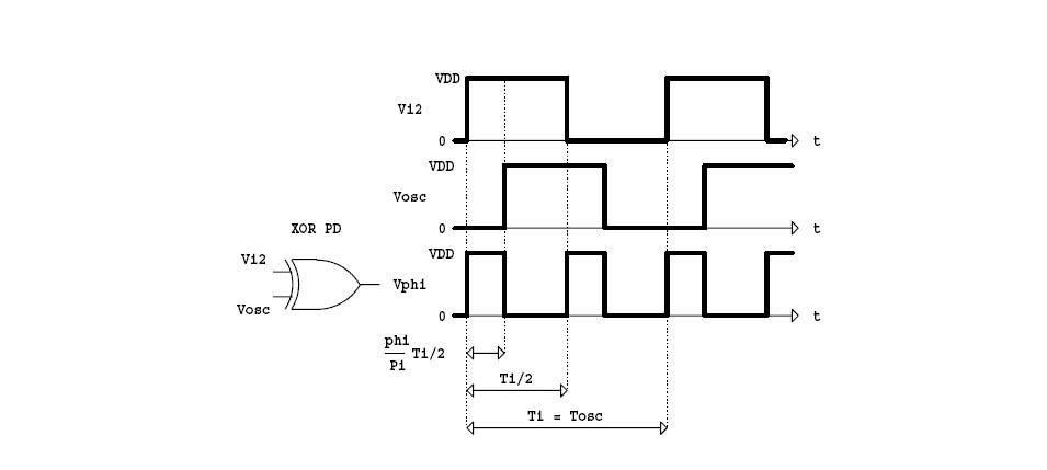

Not just a typo, it's a wrong definition.
The Phase Detector detects the instantaneous Phase Difference between the two signals. This of course means that when the input frequencies are different, the output varies on each input cycle. The Low Pass Filter averages this output and sends an almost-DC voltage to the VCO to change the VCO frequency to match the input frequency.
As the two frequencies approach each other, the output of the Low Pass Filter settles towards a constant DC value, and the VCO settles to a frequency that matches the input.
Here is a image that shows one implementation of a Phase Detector. It has an output when the two inputs are different.

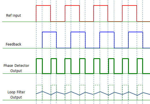

So once the output frequency matches the input frequency, will the phase detector give any output signal or will it give zero?
The output signal of the phase detector shown above is just a digital signal. The low-pass filter converts it into an analog signal:
Be aware that this simple phase detector only works for "small" frequency deviations. It will give the same output for all harmonics of the "ref. input".

That depends on the particular Phase Detector (PD) design and on what the VCO needs.
In the usual simplest case, the PD will put out 1/2 the maximum control voltage when the two equal-frequency input signals are 90° out of phase. The design procedure then is to use component values for the Oscillator so the desired frequency is generated with 1/2 the maximum control voltage. This allows the widest oscillator frequency range above and below the input signal frequency.

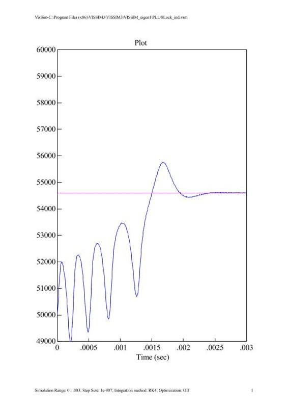

No - that is wrong. A PLL is able to lock only when both frequencies are approximately equal (within the so-called "lock range"). The PLL is a strong non-linear system and the "lock-in" procedure is rather hard to analyze. But it can be easily simulated . But the error signal from the phase setector is NOT proportional to the difference (fi-fo).
Only when both frequencies are nearly identical and the phase difference is smaller than (let`s say) 30 deg away from the nominal case (which sometimes is 90deg) the system can be regarded as quasi-linear and the phase detector output is a measure for the phase difference.
Only under these condtions the linear model as shown in your first post is valid.
EDIT: Next I show you how the lock-in procedure looks like (simulation). The frequencies are 50000 Hz (VCO start) and 54500 Hz (input). As you can see, the mean value contains a DC portion which causes the VCO frequency to move "slowly" and not in a linear manner to the input frequency - until both are equal (locked condition).
By the way, the quoted text from the website is rather vague - better: It is mainly wrong. Don`t rely on such vague (anonymeous ?) information.

This is where I have doubt. If the difference between input and output phase is zero then the output of LPF will be zero and thus the VCO will get 0 signal in that case?
Or maybe the final stable has to be like there's a constant phase difference between two signals?
jaus tail said:
... the final stable has to be like there's a constant phase difference between two signals?
Correct.
The VCO will require a DC input voltage that will determine the VCO output frequency.
When locked, the low-pass filter will pass that DC component to the VCO control input.
There must be sufficient phase error to generate that average DC voltage.

I think, some additional clarifications are necessary...
1.) Again, we strictly have to distinguish between the two cases: (a) out of lock and (b) in-lock.
The mathematical analysis of the PLL under locked conditions is relatively simple. It can be modeled as a linear classical control system - in most cases of second order (input and output variable: Phase) .
2.) However, if the loop is out-of-lock, an exact mathematical analysis is nearly impossible (strongly non-linear). But a circuit simulation can show what happens and if the loop can acquire lock (see my former post).
3.) Because the loop gain was mentioned before:
In the PLL we have no DC gain at all (and no DC error). The transfer function of the loop under locked conditions is a phase-out-to-phase-in type and the loop gain has the unit 1/sec.
