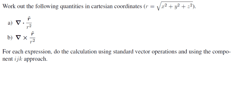

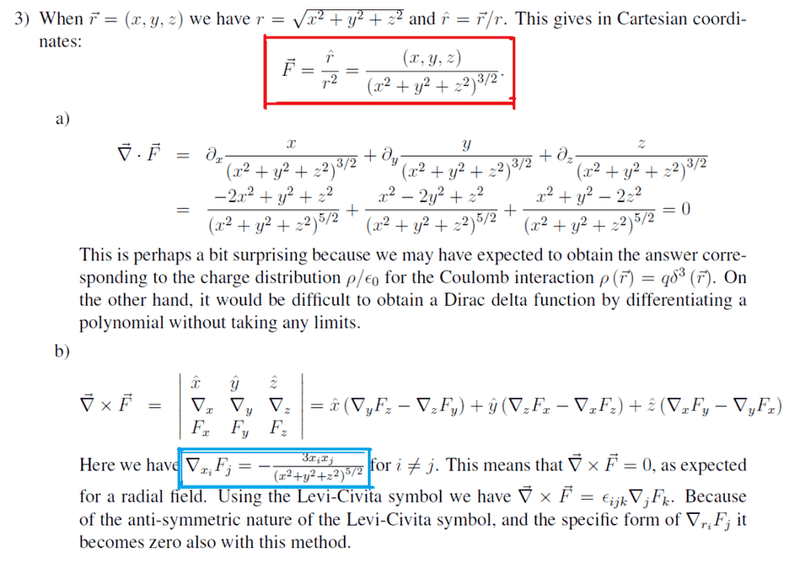

can anyone enlighten me what the red and blue equations mean? i remembered something about the red eqn meaning unit vector in vector format, or scalar format is it?
and the blue eqn i have totally no idea what my prof is doing >< is he trying to say that del F is a dot product and since they are 0 because i =/= j, that means that cross product is 0?
help appreciated!
hi quietrain ! :smile:
it's all very simple …
r^/r2 = (r/|r|)/r2 = r/r3
and
∂/∂xi (Fj)
= ∂/∂xi (xj)
= ∂/∂xi (xj/r3)
= {∂/∂xi (xj)}/r3 + {∂/∂xi 1/r3)}xj (product rule)
= 0 + {∂/∂xi 1/r3)}xj :wink:
with regards to part b)
for the cross product (del X F) to be 0, are they saying that delyFz - delzFy must be 0 and the other permutations too,
so that delyFz = delzFy
but from the form ∂/∂xi (Fj), it has a minus sign after differientiating, thus for Eijk, if we swop once to Eikj , then the minus sign is gone
so now its minus - plus = 2 minus , not 0?
hi quietrain! :smile:
(have a del: ∇ and an epsilon: ε :wink:)
yes :smile:
ah, you can either write ∇jFk - ∇kFj
or εijkjFk
same thing :wink:
yes :smile:
or εijkjFk
same thing :wink:
oh so it becomes minus minus minus which is minus plus = 0
thanks!
