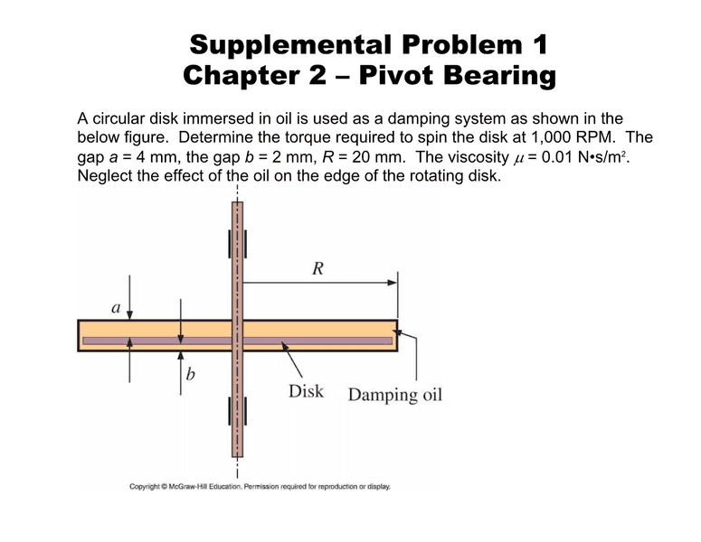

the picture has all the information
I am assuming we will be needing the viscosity equation, tao= mue(dv/dy) where v is velocity
I do not know how to approach this exercise.

If you had a viscous fluid between two parallel plates, with one plate moving at velocity V and the other plate stationary, would you know what to do?
I think so, would it be the same as sliding a flat surface over a container full of fluid? if so, the fluid would have some viscosity and will retard the flat surface after giving it a push and F= mue(velocity/area).
What I don't understand in my original question is how will I go about the disk being "a" distance from the top and "b" distance from the bottom? I will be using the Couette flow equation if I am not mistaken
I forgot the force will be directly proportional to the Area

You are aware that there is a difference between angular velocity and linear velocity, correct? The relative linear velocity is a function of radial location r. What is the relative velocity of the plates as a function of r?
Yes, velocity =omega(R) = 1000 rpm X 2pi rad/minute X R
So what is the shear stress on each side of the disk as a function of r?
