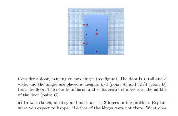

Diagram of a door in a wall opening, with hinge points A and B marked on the left edge at heights L/4 and 3L/4, the centre of mass C at the middle, and width d labelled along the bottom.

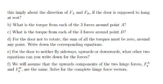

Printed text questions b through f about a door in static equilibrium: torque about points A and B, sum of torques, force balance equations, and hinge force vectors with equal upward components.
Torque = r x F
I expect the door to fall.
That is your full solution to all of those questions and drawings? I'm not expecting you to get full marks for that solution...
ErCeTe said:
No, that was for a) only.
Well, first of all it's not correct (insufficient explanation of the door motion). Second, part a) asks for you to draw a number of things. Try again? :smile:
