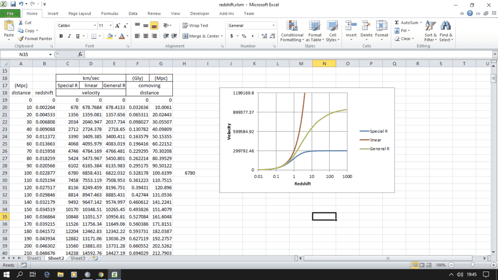

There are two aspects you are talking about: 1) the looking back into the past and 2) redshift - meaning the objects are receding from our point of observation.
A simple example demonstrates the first aspect: Take the Sun which is about 150 million km from Earth. In terms of light speed, this is about 8.3 light minutes. Electromagnetic (EM) radiation including light and heat travels at the speed of light. Therefore when we look at the Sun now, it is a picture of what it looks like 8.3 minutes ago.
## T = D/S ##
where T = time in seconds
D = distance in meters
S = speed in meters/second
So if for another object the distance is greater, the more in the past we are looking. Because it takes that much time for light (EM radiation) to cross that distance.
However, regarding the second aspect, the EM radiation that we observed from distant objects has longer wavelengths. The more distant the longer the wavelengths. That is called redshifted. This means that the object in question is receding from our point of observation.
## v = H_0 D ##
where v is recessional velocity in km/sec
##H_0## is the Hubble constant
and D is proper distance in Mpc
So an object that is, say, 100 Mpc from us, would have a receding velocity of 6780 km/sec (taking the Hubble constant to be 67.8 km/sec/Mpc).
The relationship between redshift and recessional velocity is as follows:
## z = \sqrt{\frac{1 + \frac{v}{c}} {1 - \frac{v}{c}}} - 1 ##
where c is the speed of light.
So the redshift (z) is 0.022877
This is only true in flat spacetime. The spacetime of our universe is not flat. In a curved spacetime, there is no well-defined "recessional velocity" between spatially separated objects, only different coordinate-dependent quantities that don't have direct physical meaning.
For small enough distances and redshifts in our universe, spacetime curvature can be ignored and the relationship you give, as well as the linear velocity-distance Hubble relationship, can be taken as valid. However, at larger distances and redshifts in our universe, these relationships are no longer valid.
Yes we will need General Relativity (GR) to calculate recessional velocity.
As I said, "recessional velocity" is coordinate-dependent and has no physical meaning for spatially separated objects in curved spacetime. It's unfortunate that cosmologists continue to use the term and convert directly observed redshifts into this physically meaningless quantity, apparently because they believe it will make more sense to lay people. IMO it only causes confusion.
