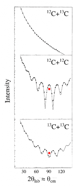

Unfortunately the link to the picture doesn't seem to work either, but I think I see the one you're talking about. You can absolutely see beats in the angular distributions of the scattering of identical particles in nuclear physics. Here's an example for different carbon isotopes (homework question: why does 12C scattering look different to 13C scattering?):
Three stacked plots of intensity against 2θlab ≈ θcm: top, 12C+13C, a smooth decreasing curve; middle, 12C+12C, an oscillating curve with deep minima near 70 and 100; bottom, 13C+13C, a shallower oscillating curve.
From Plattner and Sick, EPJ 2 (1981) p. 109 iopscience.iop.org/0143-0807/2/2/008

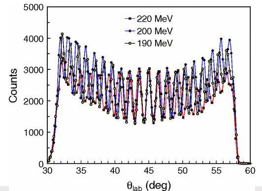

Though my favourite example is 58Ni + 58Ni.
Line graph of counts against lab scattering angle from 30 to 60 degrees for three energies, 220 MeV, 200 MeV and 190 MeV, showing rapid oscillations with counts between about 1000 and 4000.
From Hinde et. al. Phys. Rev. C 76 (2007)
Thank you. That means that the phase of each source has some physical meaning, and if we change the phase of anyone beam the interference pattern will shift? And how about temporal (as opposed to spatial) beats, where we plot the intensity at one point as a function of time?

I suggest you read this. https://www.ikp.uni-koeln.de/students/fp/download/AnleitungVers19eng.pdf or http://www2.ph.ed.ac.uk/~gja/qp/qp13.pdf or https://people.nscl.msu.edu/~nunes/phy982/phy982-isospin.pdf
(I rather like the first and third treatments).
To be honest, I'm not sure what you're getting at here. The beam doesn't have a well defined phase that you can change, nor would there be a temporal beat.
I see that now. I misunderstood what is happening in there.
Cool. I hope my links helped. Scattering of identical particles totally blew my mind when I learned about it. There's even a measurement of 208Pb + 208Pb scattering. Awesome experiment.
