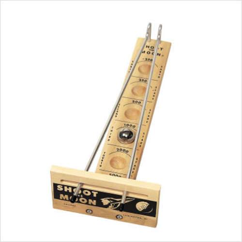

There is a "shoot the moon" toy, that has a steel ball resting on two hinged rods that the user can move:
The rods are initially held together, with the ball at the far end of the toy. The rods are then spread apart so the ball starts rolling downwards and forwards, generating angular momentum. Then with a learned timing, the rods are then smoothly brought back together at a decreasing pace, which apparently adds energy to the system by "squeezing" the ball, which moves it forwards and upwards, and the ball's center of mass does actually move upwards.
