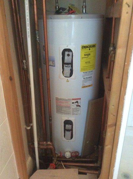

Hi all,
I've just moved to a house in the Highlands whose previous owner was American, and insisted on installing US appliances, presumably shipped over at great expense. I wonder if our US friends on here could help with the water heater:
Is it just California state law to write all that guff all over it, or is it everwhere? UK heaters have hardly anything written on them.
Anyway, it has a two-heater arrangement that I'm not familiar with. The upper heater seems bigger, and has some kind of switchover so that only one heater can be activated at a time. In the UK, the suggested temp is at least 55 or 60 degC to prevent Legionnaire's disease. In any case, it doesn't output enough hot water, so I want to turn it up - do I set the lower to 60 and the upper slightly higher, or will that just permanently deactivate the lower heater?
Any help greatly appreciated.

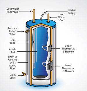

Here is a link that describes the basic operation:
http://www.whirlpoolwaterheaters.co...ter-heaters-work/standard-electric-operation/
Set both thermostats to the same temperature. If any thing, set the upper one slightly higher.
The purpose of two thermostats is to work on the water you will use next to the correct temperature. Then with that reserve available for immediate use, the remaining water is heated by the lower element.

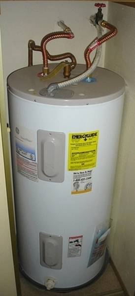

Looks a lot like this one:
The reason the top element looks bigger is because the thermostat itself is larger. The heating element itself is not larger. The thermostat is larger because it is responsible for switching off the lower thermostat when the top thermostat calls for heat. Only one element ever runs at a time.
Thanks to you both. I've set them both to about 60 degC, with the upper slightly higher as suggested.

Maaaan those are two pictures of some wickedly ugly installs...anyway in OP from what I can make out of the markings on the sticker omlette your water heater seems to base the energy guide ratings on around 0.10 dollars/kwh. Putting the age of the water heater at maybe early 2000s, or sooner, unless I miss my guess? Worth a look at replacing someday as I've seen standards on insulation ect come a long way since then in NA products.
Yes, some kind individual has boxed in the tank so I can't get it out without cutting the pipes in front. Also, it's odd that the tank has no provision for an indirect coil to heat it with the oil-fired range cooker (Rayburn) that runs the radiators.
You could be right about the age. It's all going to be torn out soon anyway, as the entire heating setup is being replaced with a wood chip boiler system.
